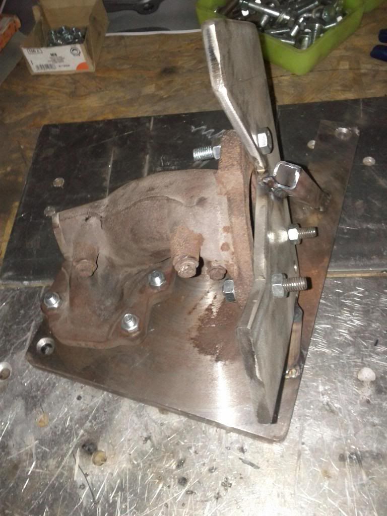

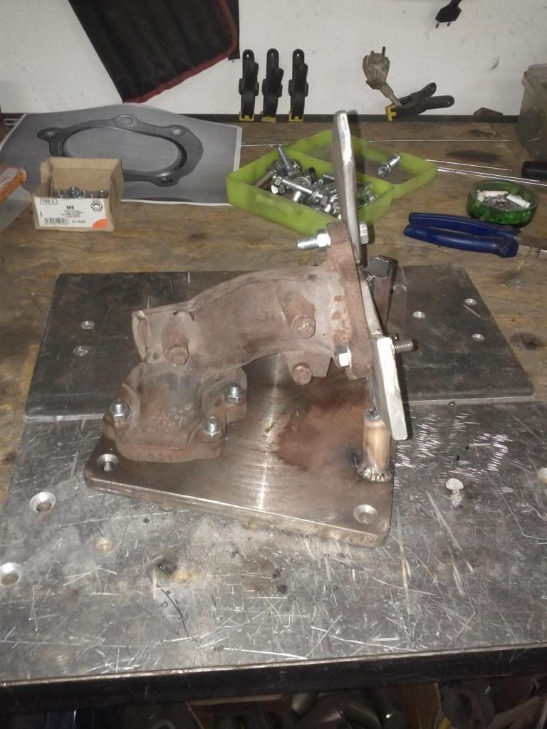

Now that you've pointed it out, I can see what you mean. - Something similar though; that looks like the right bolt pattern on each end, but there's no lambda boss and it clearly had a heat shield.What downpipe is it going to connect to as that's not a gti-r elbow.
The turbo flange side of it is the same so I doubt it would take long to modify the jig you've already made ;-)Feck me............good eye man!
That means I have to make another jig now
I'd say so looking at the angle of it, the downpipe flange on the 200sx elbow is at around 70/80 degrees to the turbo flange and about 120 on the gti-r which was the first thing i spotted :lol:Now that you've pointed it out, I can see what you mean. - Something similar though; that looks like the right bolt pattern on each end, but there's no lambda boss and it clearly had a heat shield.
Is it a 200SX elbow?
