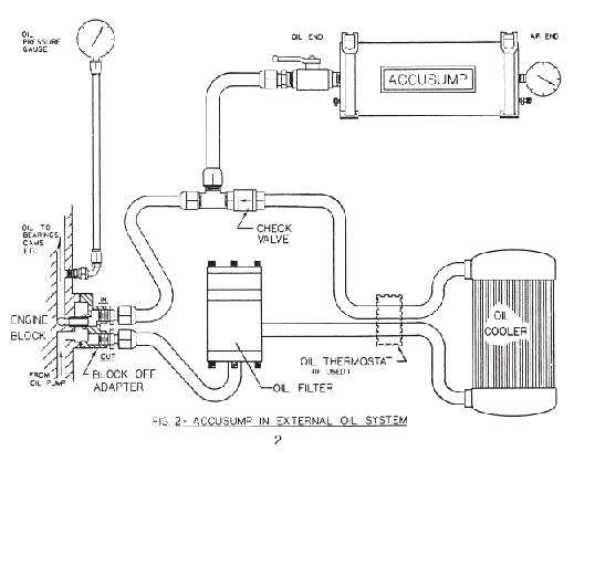

Then why does the image in the instruction manual show a check valve? How do you prevent the oil flow backwards through the oil pump?

There was a check valve in the kit you supplied me mate, but thats for an oil cooler set up (as ducie54 has shown).

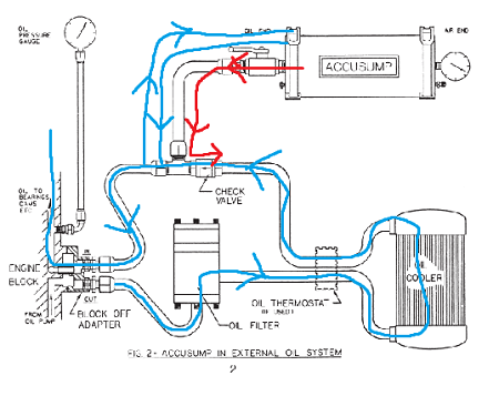

James check the image for the location of the check valve in the system. Its there to stop flow backwards thought the oil cooler, filter then the pump. Not the other direction.
Another pic for the challenged.
Most efficient way IMO would be to remote mount the oil filter with a check valve that way ur not reling on the oil filter and pump to stop oil flow in the opposite direction. Well thats how im doing mine.
Yer I see what you mean mate, the check valve is needed in that setup, but in the setup i shall be using (straight into the oil filter stem) I wont need the check valve.
