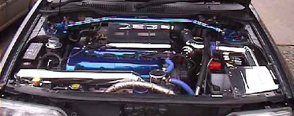

iv got a shaped piece of steel for the intake pipe with samaco' s joining it to the tubby and and maf :wink: puts it in the original posistion. iv got the same style fmic as you btw.
hope this helps, Stu

just had a look at the specR intercooler..which one have you got? the one with the in/outlets on the side or the other where they come out of the top?
is this it?

Those look like standard Samco hoses, you may run the risk of hose collapse without proper suction hoses :?

:shock: doh! they came with the maf and filter
I'm only stating what we would put on a hydraulic system, but I don't see why it would be any different here when your turbo is sucking big stylee!
I know that Audi TT's suffer from it (guy at work has one :wink: ).
Put a seperate post up to pose the question, see if anybody has had any problems.
OZ-Racing
Sorry Dooie,
Just spoke to my TT man and he said that the standard pipe on the TT used to collapse and had to have a sleeve inserted, but the samco hoses were ok.
It could still be a problem if the length of hose is too long and you are using bends aswell. I not sure matey :? :lol:

s' ok mate im gonna be losing that intake when the map sensor goes on :wink: cheers for the heads up though, iv always thought they felt a little soft to use :?

yes its the right pic m8 if that helps
