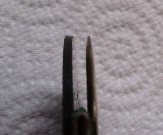

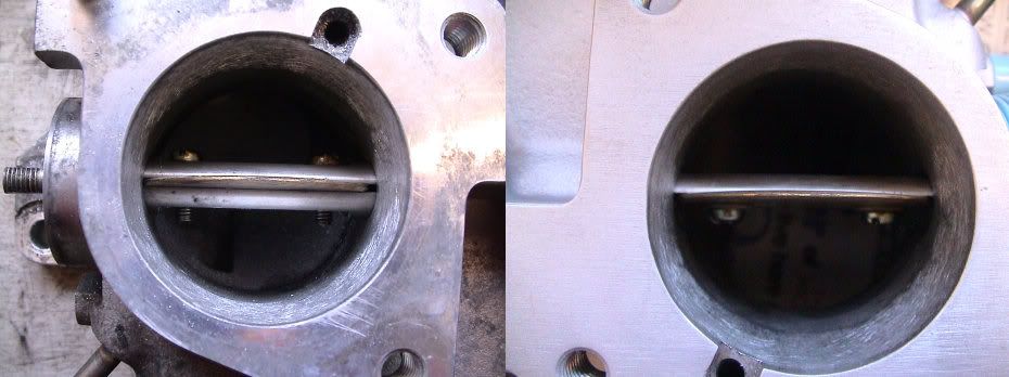

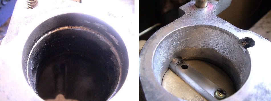

Heres some inspiration for what to do when its all apart
