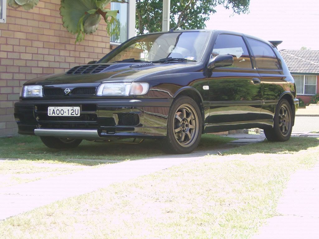

best size alloys for 94 gti-r? currently got 15inch technomagnesio superlightweight but maybe i need to go up a size? first pulsar so not sure whats best for performance?

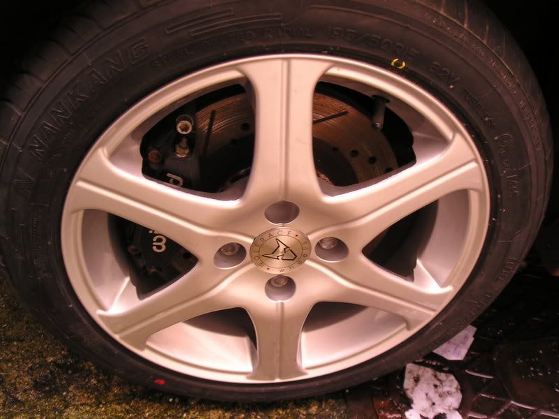

Totally agree..... 15" is my prefered choice although you are limitted with style of wheel to allow for an uprated brake kit or you will have to fit spacers.Dooie Pop Pop said:15' s are best for handling imo, not too heavy (less strain on your gearbox) and plenty of tyre wall to flex when you need it
17' s are for poser boys:lol:
You can get the 310mm wilwoods under 15's and 330mm Ap's will fit 16's, depends on spoke clearance though ;-)antgtir said:Depends on if you are thinking of upgrading your brakes.
If you are, 16" is ok for the Wilwood brand however for others such as Hispec, Brembo, and bigger 6pots, it would have to be 17"
Ant.
