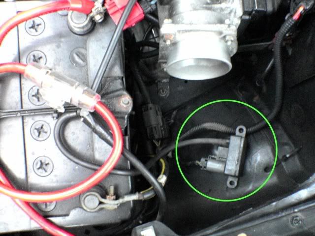

my boost gauge (standard) doesn't seem to move from 0?
could somebody post a pic of the connection under the bonnet so i can locate & reconnect?
Thanks
Look on the inner wing at the end of the filter. The little plastic thing is what you're looking for.

Find this thing matey on inner wing under maf. I think this should have vac pipe run to gauge.

That pic was spot on - it works fine mow cheers.
