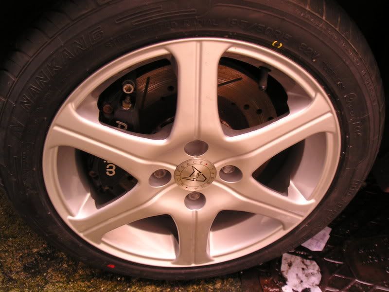

does anybody know if 15" rota grids will clear wilwood 4 pots without the need for spacers??? offset is et40 i believe

When I had clearance issues with my 15" Buddy Club I asked which members were running 15's over wilwood 280mm kit and I'm pretty sure Rota was a wheel that did fit. My Buddy Club are ET42 and they do not clear the kit but I then bought a set of Team Dynamics pro race 1.2 ET35 which cleared the calipers.

i havent got 15" rota grids but im sure my offset is 38. but i think it also has something to do with the spoke design aswell.
i have loads of space i can stick my little finger down between caliper ans spoke.
