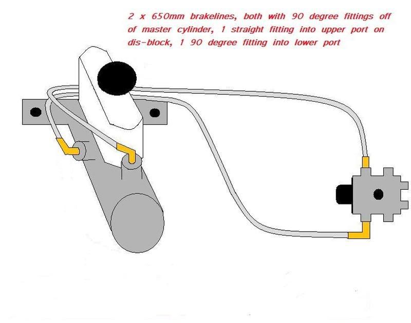

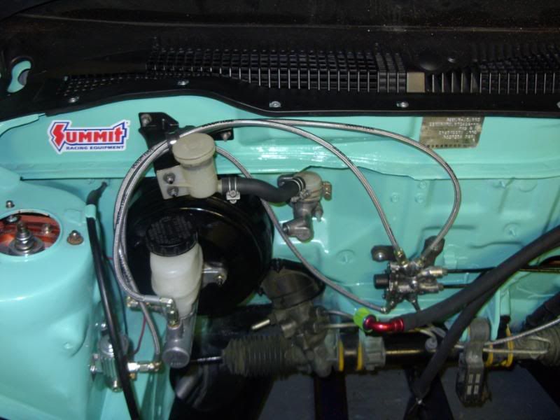

I need urgent help on sorting brakes. Just finished rebuilding crashed car. Donor had ABS, this was scrapped, used my master cylinder, pipes and four branch pipe splitter on bulkhead. Im sure that I have both front pipes going into Fs and rears into Rs. I am unable to get good pedal after continuous bleeding and am sure there is no air in system. I am getting braking on left front only, and car wants to swing around. This is after a couple of pumps on pedal. It has Willwood four pots all around and these have been superb up to the crash. Am going to try and put it on brake rollers next week, but this is not easy as car in not registered for road. On four way splitter there is a small cylinder on end. Am not sure what this does. I would be glad of any help. cheers den.
