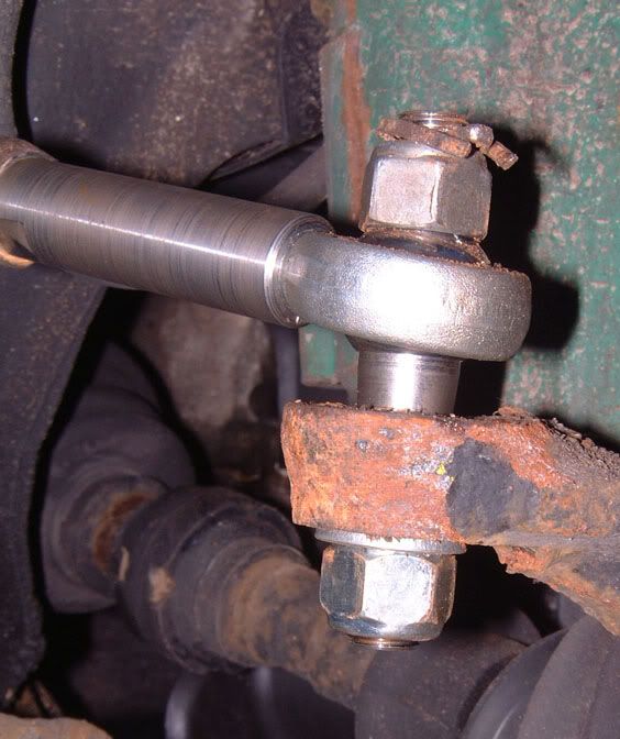

I have the Powerstation kit fitted and one of the rosejoints failed on the MOT so after having 3 sets of bearings sent out I finally have the right ones being 1/2"x1/2" UNF(I hope-not the fault of the supplier btw).Now the PS bearings sat directly on the hub and the Gordon Kaye ones I have seen seem raised above it.My question is, if I use the 10mm tophat spacers that came with the bearings to lift it above the hub allowing it to move freely rather than being restricted by the hub, will it drasticly alter the bumpsteer?Does the height of the bearing in relation to the hub contribute directly to all the benefits of fitting a bumpsteer kit?
