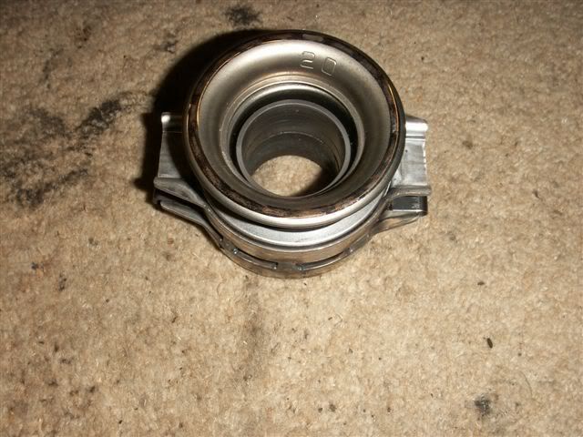

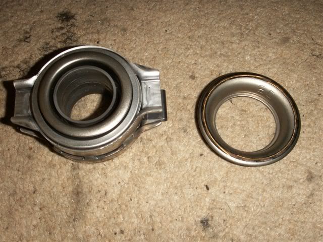

MINESGTIR
heres how
What we did was machine the blots to fit, piece of ****, then modified the release bearing to fit : ho
to be honest it works so well , never judders, smooth as a babys ass, no banter in traffic, ive launched it a few times and it loves it !:thumbsup:
hope the pics help :
