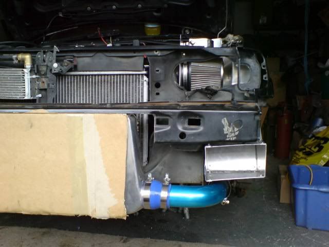

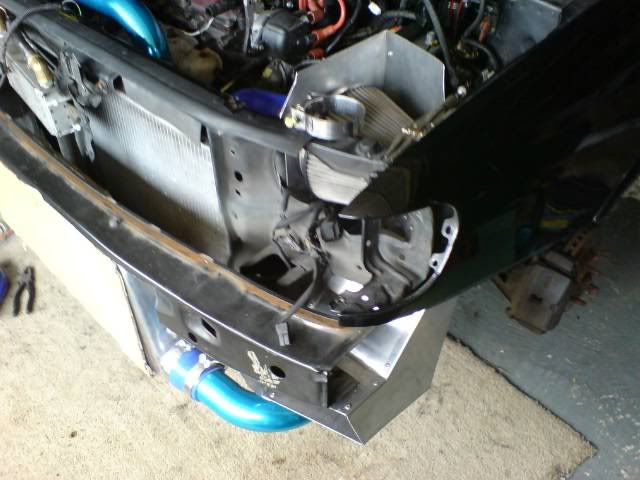

MINESGTIR said:
why dont you make this up.. surely its a better idea?
could knock it out in a weekend!
That’s a very good bit of DIY :-D
No disrespect intended……….but you might have the ability and tools e.t.c. to "knock it out in a weekend" but not everybody has the time, inclination or equipment to fabricate something like that.

Minesgtir, that air intake ducting looks great and I bet it works really well. Good job!
With the other method, I'd be a little worried about re-directiing all the air from the bonnet air intakes as it gets very hot under there and it's not unknown for brake and clutch problems due to the fluids getting too hot.

Minesgtir,
That does look like a rather fancy bit of kit.
I know the brake cooling ducts aren't that great but if just a extra little bit of cool air reaches your brakes, surely that's a good thing? Don't get me wrong, I'm not knocking what you have done.

Personally, I think Minesgtir is the best kit, both technically speaking and from an ease of installation perspective, with minimal prerequisits to fitting (you just need to move the battery iirc ?!) If he could knock some of these out, I'm sure he'd have a lot of takers, me being one of them.

MINESGTIR
everyone has their own ideas for intake and induction..
IMO the brake ducts are shit and dont do anything..
you wouldnt believe the difference a direct cold air feed makes with larger intake hose to the turbo... it sounds so much louder and makes very noticable performance gain.
