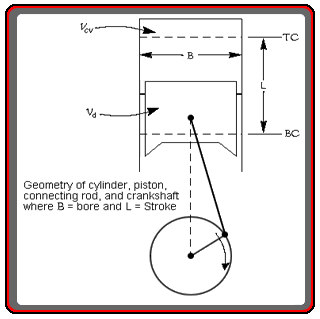

Compression ratio is defined as:
Or
Where:
CR = Compression Ratio
Vd = Displacement Volume
Vcv = Clearance Volume
Or
Where:
