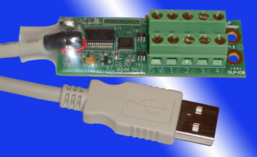

On the ECU itself, it doesn't give me the option to connect via a RS-323 port only via USB, which seem to be a DLP-IO8-G connection (see below) that people are using.
All very confusing to start off with, but the more I look at it, I get the feeling that I'm going to have to get hold of a DLP-IO8-G connector and if so has anyone got any wiring details on how to wire my wideband in to the DLP-IO8-G?

If your laptop has 15pin that's VGA out, you wont be using that! The DLP-IO8-G is just an 8ch analogue to digital converter. When you plug it in, it will show up as a com port (after installing drivers). You just need to launch nistune and tell nistune via the configuration page what com port the DLP is connected to. Nistune then takes CH1 on the DLP and uses this as the wideband input. You will need to connect ground and the 0-5v out of the wideband into the DLP to get a reliable signal.

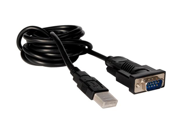

IIRC, you have already purchased a 9pin connector so you will need a serial to USB converter.
Something like this is cheap :
http://www.ebay.co.uk/itm/USB-2-0-T...ting_Parallel_Serial_PS_2&hash=item35afe482d1
