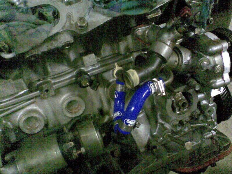

You seem you have done your investigation there. Did you test this yourself ?
As for the Custom take-off plate. It looks interesting for those going for a remote oil filter mount. I did my custom piece and will retain the same location for the filter while replaced the OE water heat exchanger for a Take-Off plate to an external air to oil cooler
http://i131.photobucket.com/albums/p298/Trip_gtir/DSCF0084.jpg

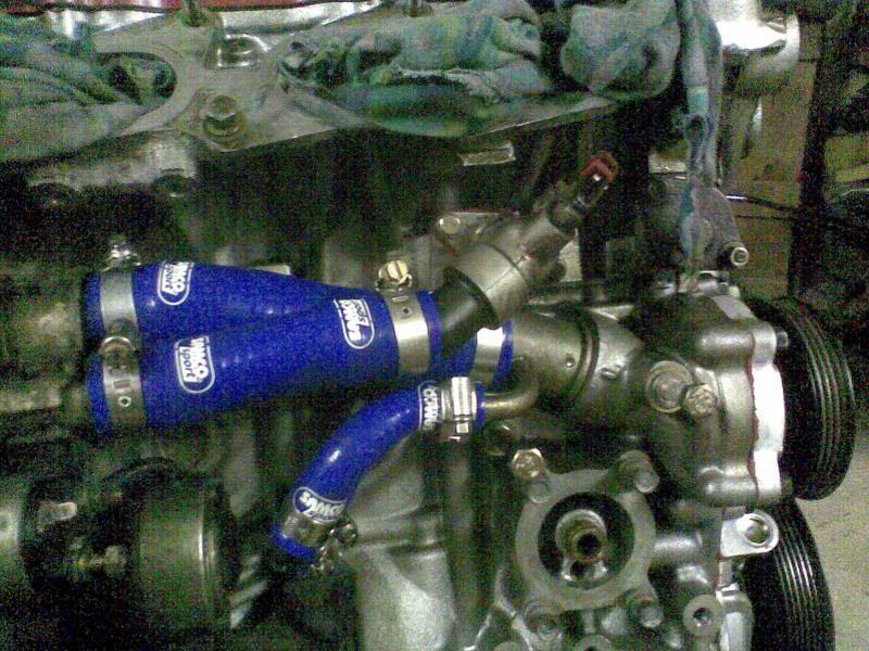

In the mean time this afternoon, i have used the same hoses of the cooler and joined them with a L piece.

Looks good there Trip.

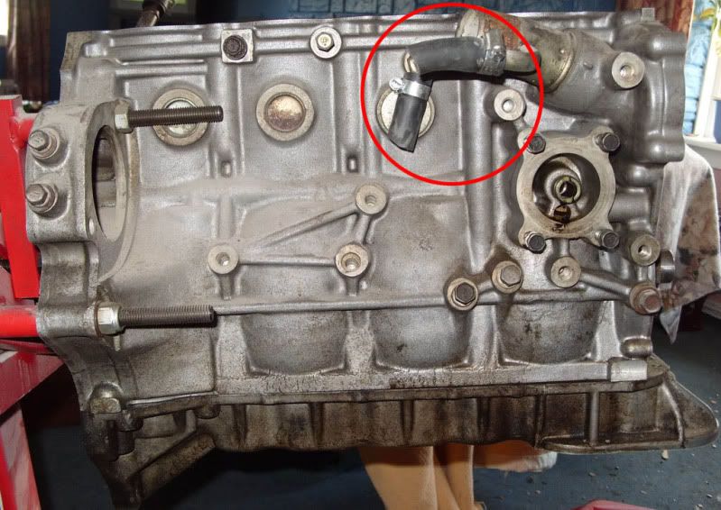

I've done it like this.... note that the coolants lines are plugged (alloy plugs) to reduce bypass of thermostat/radiator from head to pump-intake.
