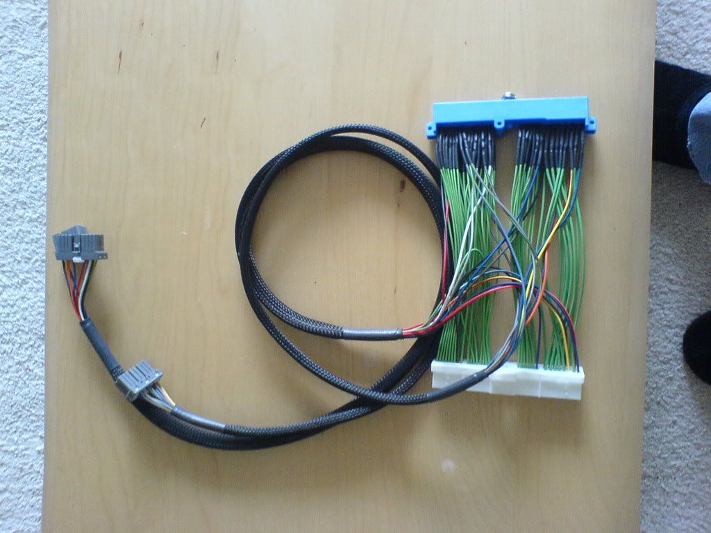

turboloon
is the loom just a simple plug and play then lads as i'm looking in to gettig this if it is plug and play...obvously i will need to get the car mapped aftter wards
Braveheart
Yes it's Plug n Play.... it links in between the OE ECU and OE ECU connection.
From the PnP harness, there's 3 plugs on a 3 foot loom that you take to your e-Manager Ultimate.
