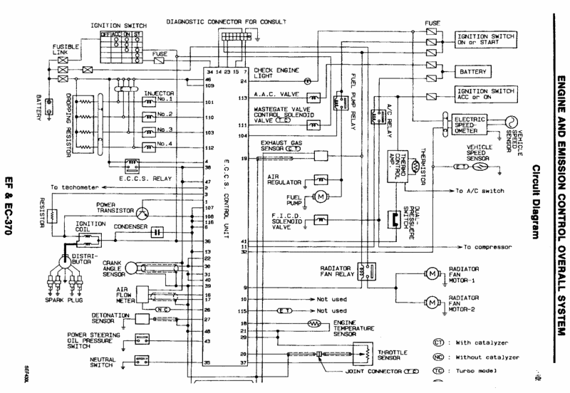

can anyone help me in finding out the ecu pinouts for the n14 gtir please, like a picture of the plug with numbers on it and a list with what they do, might even be in the service manual.
tell me if im wrong but ive heard the sr20DE uses the same pin out as the gtir? or at least the gti front eccs loom is interchangable with the r's one
cheers
