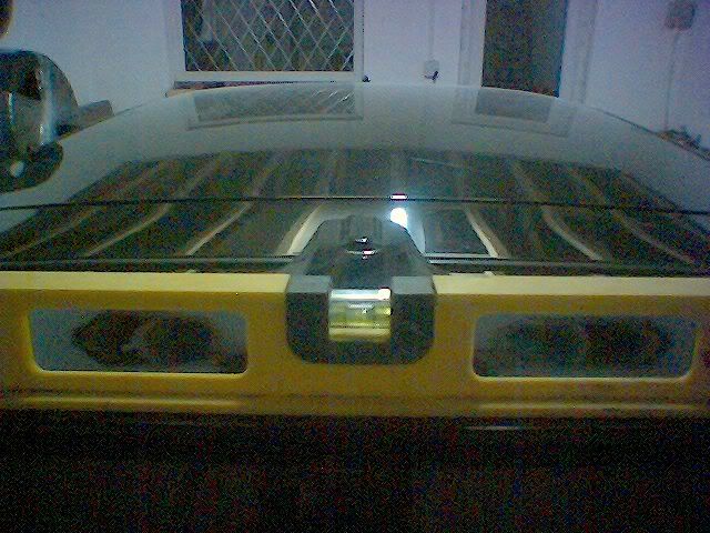

Builders Spirt level (1-1.5m)

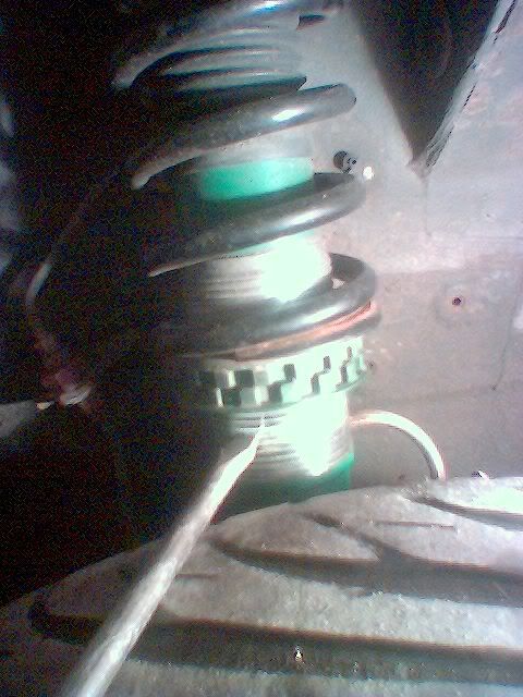

Coilover supplied spanners

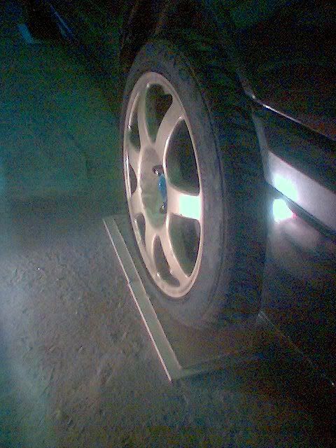

A few pieces of board (plywood, MDF) of varying thicknesses

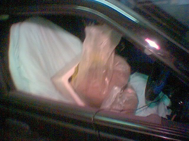

Your own body weight in Sand, Rubble, sinks ,bricks etc.

-You need to put the car on a relatively flat surface the flatter the better.
-Put your long flat straight piece of wood in line with the side to side and front to back wheels of the car. Put the spirit level on top and see how much your level is out.
-Jack up corner of the car and put under it pieces of board until the you level the floor all round underneath the tyres. If you are lazy or its to difficult, at least make sure the side to side levels are balanced. My garage floor had 10mm drop at the front and a 5mm drop at the back on the same side.
-Once your floor area is setup, mark out where you put the boards and note down how may boards you used. If and when you come to setting camber, you must have a flat surface and being able to quickly set it up again in the future saves hassle.

-Insert your virtual self into the car. I put an old sheet over the seat and then put in a 40kg Belfast sink, A bag of sand and a bag of cement as they were to hand.

-When you jack up each corner, note down the number of turns on each coilover as this is critical in balancing out the ride height.

The actual adjustment of the suspension is quite obvious and will depend on your specific coilover manufacturer but you normally turn a large nut that raises or lowers your spring platform.

-On the Tein's a turn on the spring platform equates to about 2mm in ride height difference.
-In the end I got the front balanced with an additional 2 turns on the front off compared to the front near.
