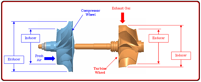

A Tale Of Two Wheels
A turbocharger is basically an air pump. Hot exhaust gases leaving the engine after combustion are routed directly to the turbine wheel side of the turbocharger to make it rotate. That turbine wheel is connected by a shaft to a compressor wheel. As the turbine wheel spins faster and faster, it causes the compressor wheel to also spin quickly. The rotation of the compressor wheel pulls in ambient air and compresses it before pumping it into the engine's chambers.
