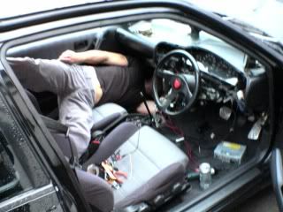

Hill_Billy
i get this aswell... almost sounds like the fan is trying to start the fucking engine....lol
just turn it up then back down and its fine....
all i can say to this pic is WTF is going on here??? LOL
CruiseGTi-R
I told him he has to re-route the boost vac pipe and secure the ECU or I'm never taking him out in the R again.
Works a treat :D
