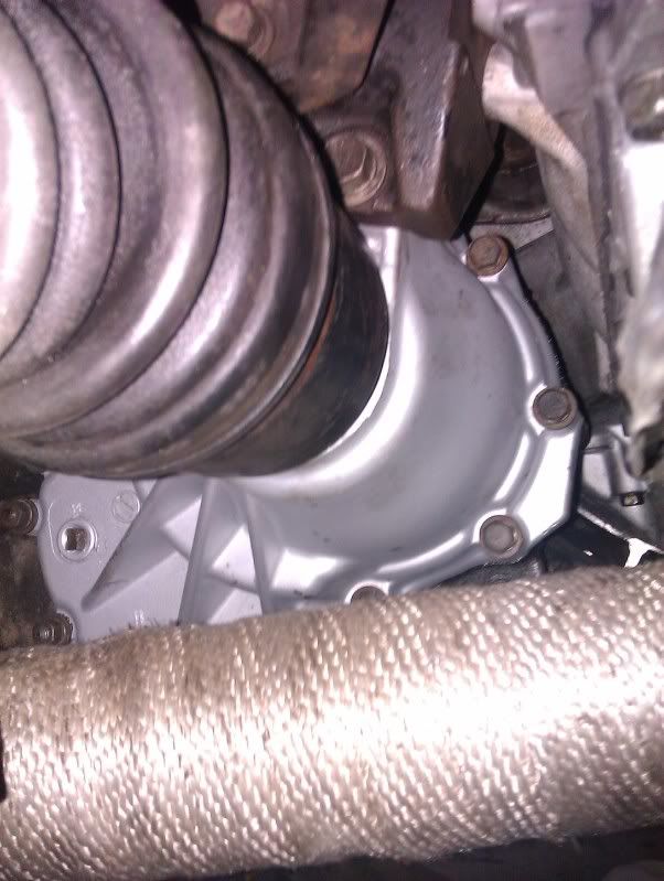

Front diff,
Remove drive shaft.
Remove the cover, about 10 X bolts and 2 nuts, also remove the bracket from tranny to engine.
And you should see the diff?

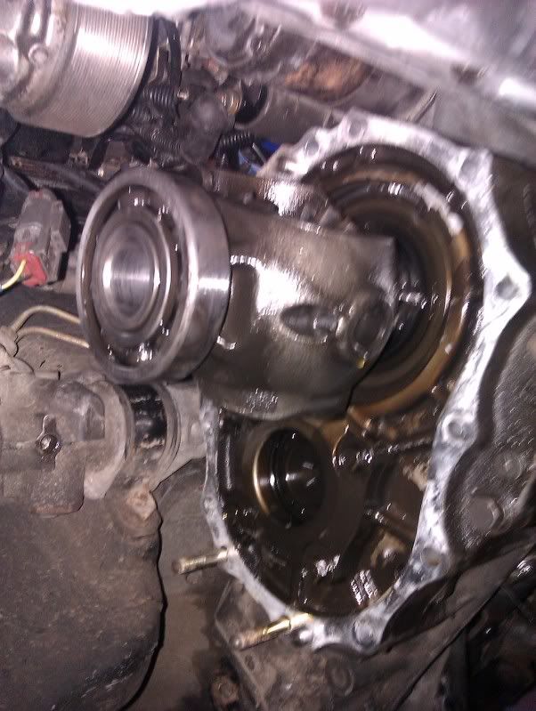

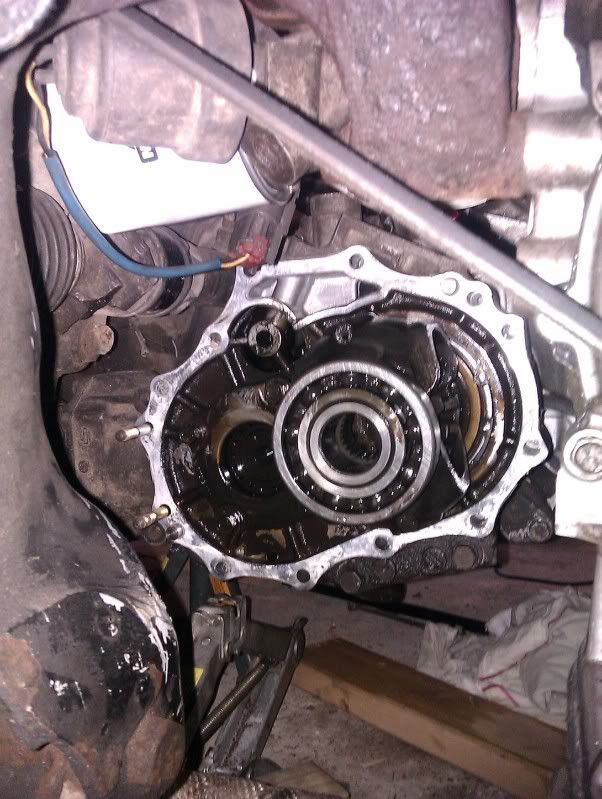

Update on this. The gearbox is now apart and its apparently the bearings, all of them.
The garage is trying to remember whether the bearings were replaced with new, but in any case I need to replace them.
Has anyone got part numbers/prices etc for whats needed?
Lastly, they'll probably be a bit of an arguement with the place that did the gearbox as to whether the bearing failure is due to their overshimming of the Quaife gearset. Any advice on that?

part numbers for the gearbox bearings are
32203-03E00
32223-79E62
32273-79E00
32203-03E13
they are on the two shafts
CruiseGTi-R
All those parts have turned up in good time Bob, no worries at all.
Cheers for the pm too.
The gearbox place are idiots if they didn't think to use new bearings, but we'll see where the argument takes us.
