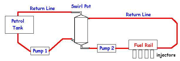

just fitted fuel swirl pot and need to fit another pump under boot floor
what size pump do i need (ie pressure out put)

Except the ones that are. Like the external (only) pump on my last carSirnixalot said:higher pressure pumps arent designed to suck
can i ask - who fitted your pump?c11gtr said:yes i mean swirl pot
the group n pump i have wont push the fuel through with enough pressure
the reason 4 the pot is when iam down to half tank of fuel it wont pickup on left handers
Yeah, I thought a build-up of pressure inside the swirl pot would just cause the excess fuel to squirt really fast back into the main tank. However, if "Pump 1" has a safety cut-off of 8 Bar, does this mean the pump simply stops working until the outlet pressure is reduced to less than 8 Bar (ie the level inside the swirl pot has decreased)? Then it can pump fuel again? Or does the pump constantly hitting it's safety cut-off cause it long-term damage?I would have thought that if you do get to the point where you're putting more into the pot than you're taking out, it will squirt like buggery back into the tank... which isn't really a problem.
