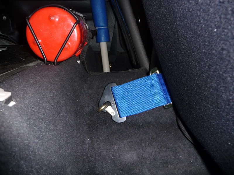

Hi all,
I`m current trying to mount the waist straps on my harness (4 point).
Have you guys fitted them through a single skin section of the floor with a spreader plate underneath?
I can put one of them onto the standard seatbelt mounting points but its just the other?
Also, have any of you just fitted the shoulder straps to any points in the boot or just used the rear belt mounting points (too steeper angle i know!)
Found this but says nothing about waist straps,
Cheers,
ollie
