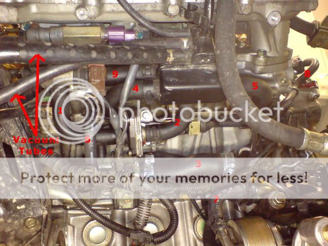

vpulsar
This is the back of the engine so as you can see no easy task to get at the det sensor but it is in there somewhere lol.
