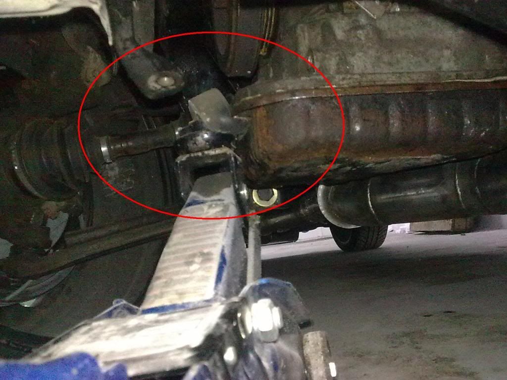

-put a jack underneath the left side of the engine (under the oil pan) and also put a rubber in between the jack and the engine so you do not dent something (I used in exhaust rubber hanger)
-lift the jack just a little bit untill your engine starts to lift
-take out the left engine mount
-lift the engine slowly until you have cleared enough space to service the specified area

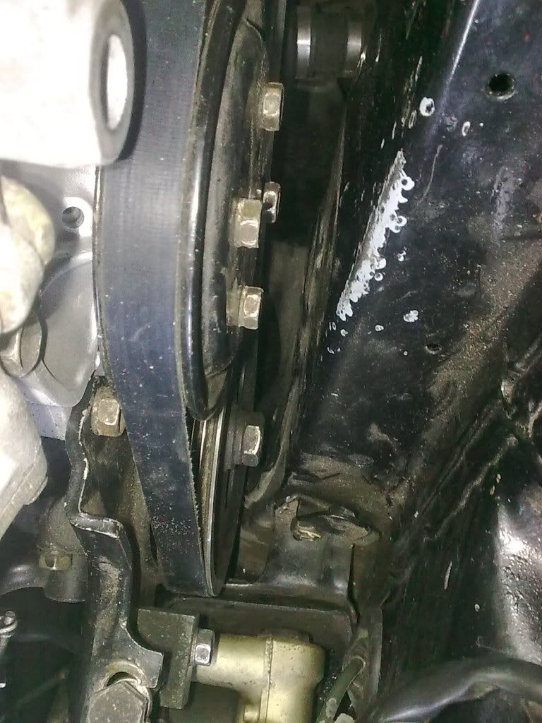

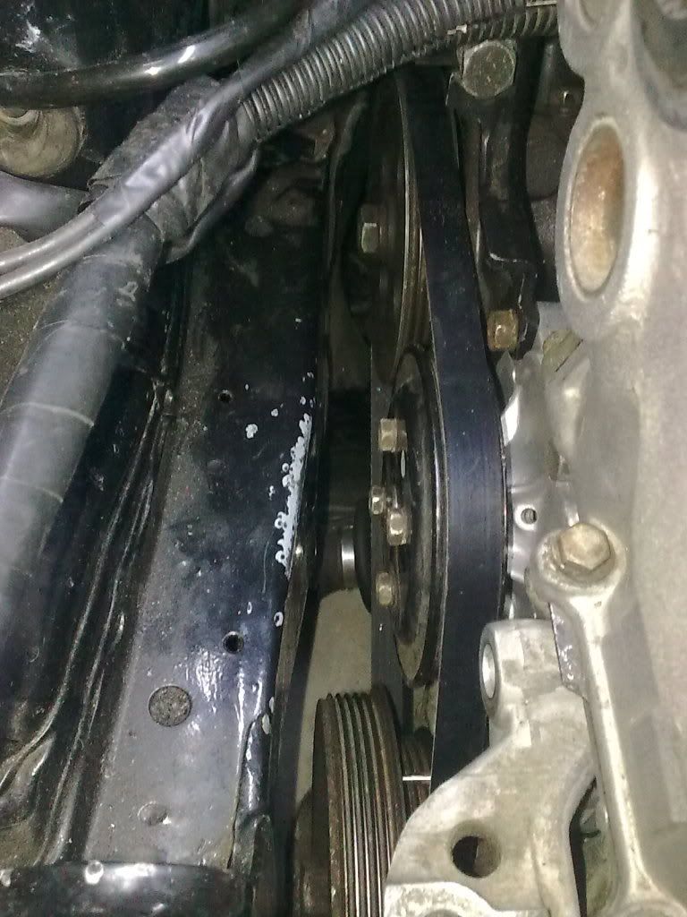

-remove alternator belt
-unscrew the 6 mm bolts from the water pump pulley (not entirely, just unscrew them untill they are free)
-take out the water pump and servo belt

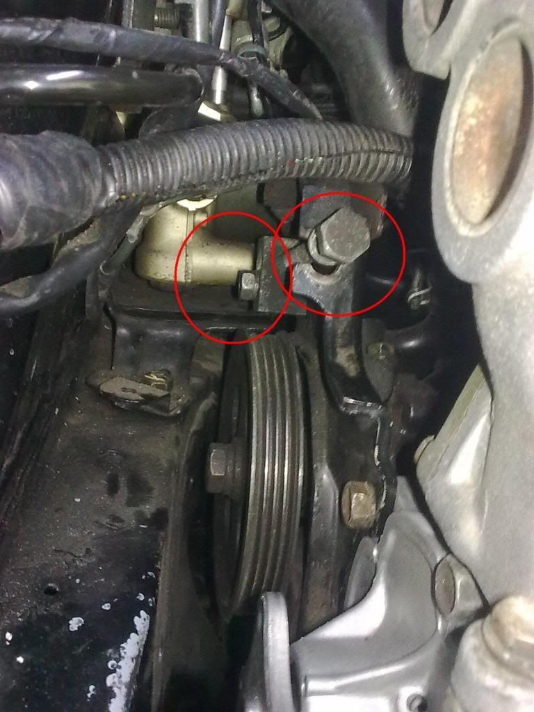

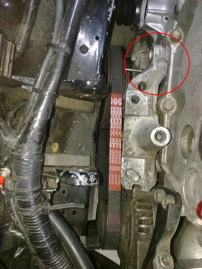

-dismantle the servo pump tensioner bracket

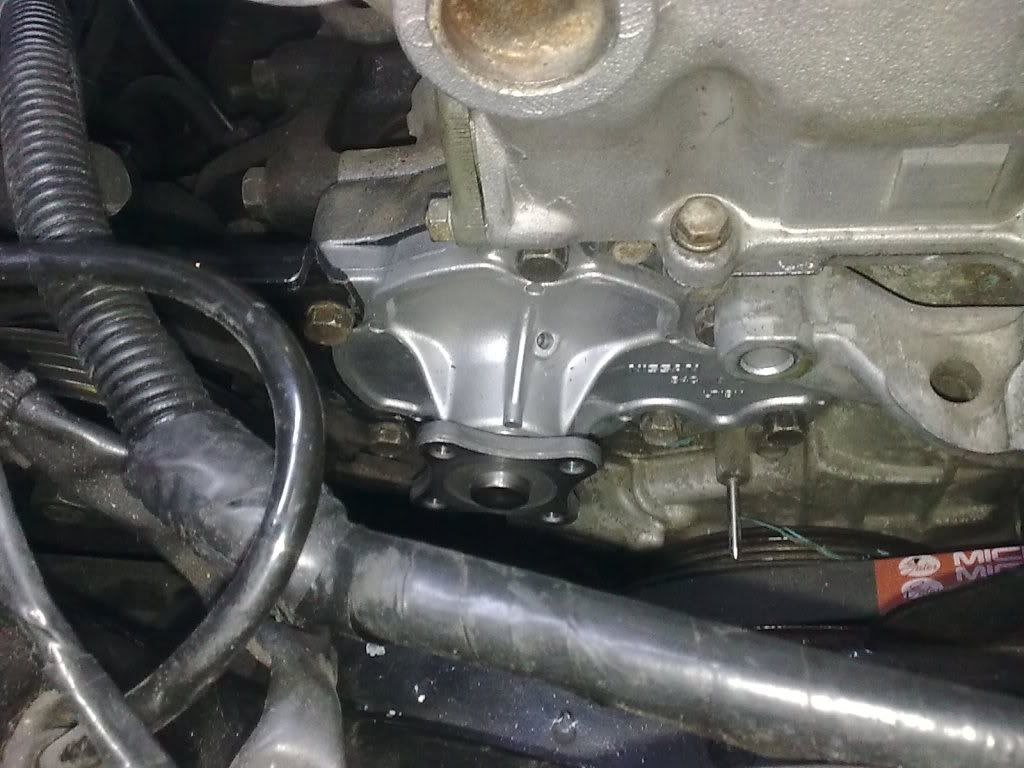

-unscrew the 8mm which is just behind the engine mount (you will clear alot of space)
-then you can unscrew the 7 bolts (8mm)which hold the water pump
-after you took out the pump clean the contact area with some solvent and a scraper for remains of the silicon gasket.
-Clean the area properly because you will have some coolant leftovers.
-put liquid gasket and then you will have around 10 minuts until it hardens
