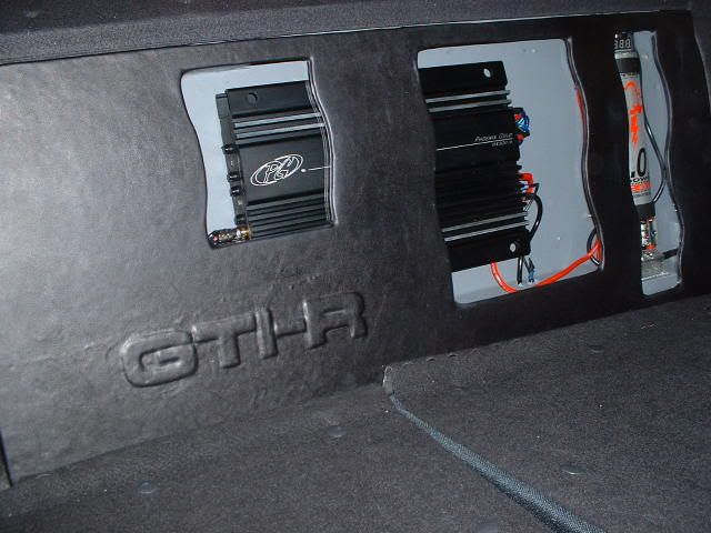

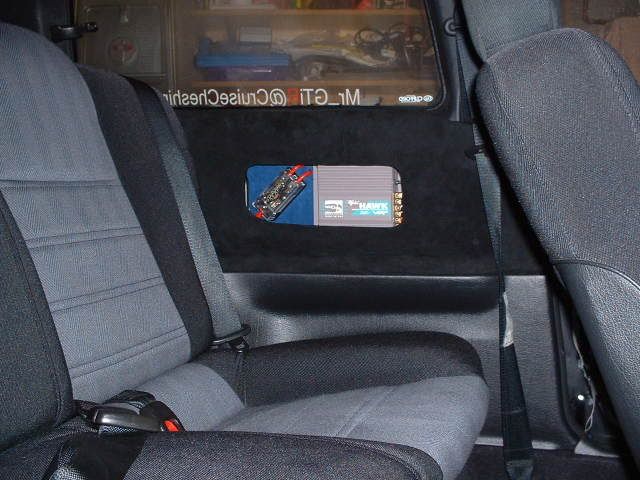

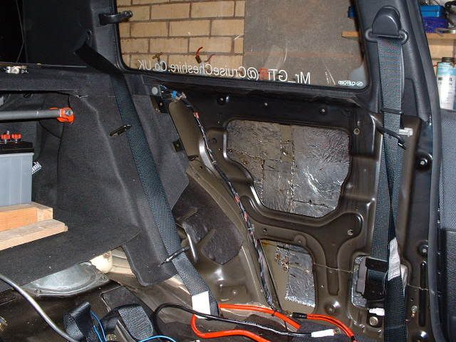

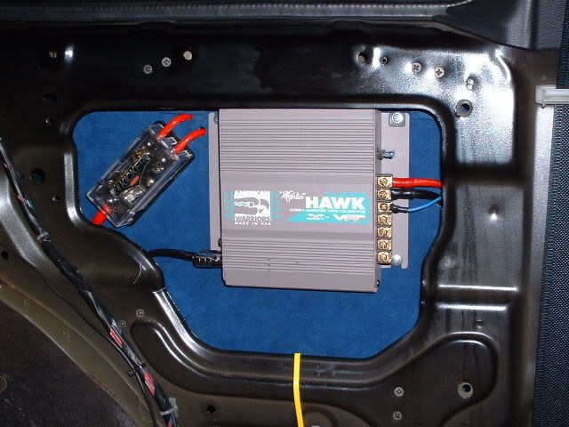

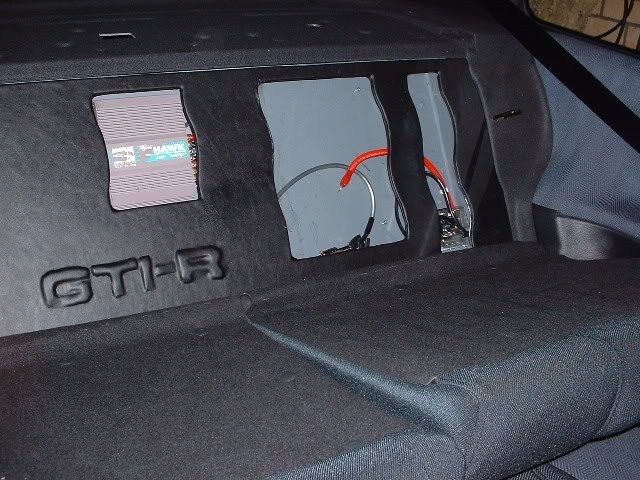

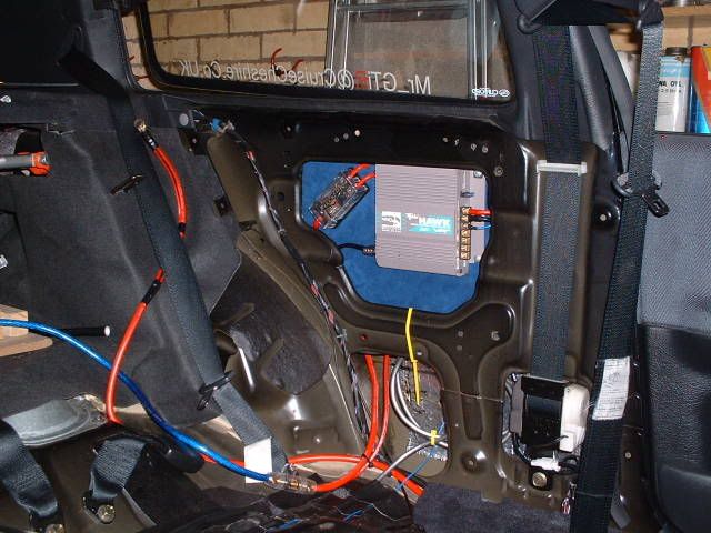

Another alternative is to mount the 6x9's in the rear quarter panels (there is enough room as my amps are mounted in each panel - see pic's below) and use them for rear fill.
With reragrds to the sub and amp, will you show off the install at all or not bothered? If not bothered just sling them in the boot and mount the amp to the back seat. If you want an install here is one i made years ago and was simple to do.
The best thing about this install is that i could go to shows and leave the back seats down and have the car locked up and not worry about it.

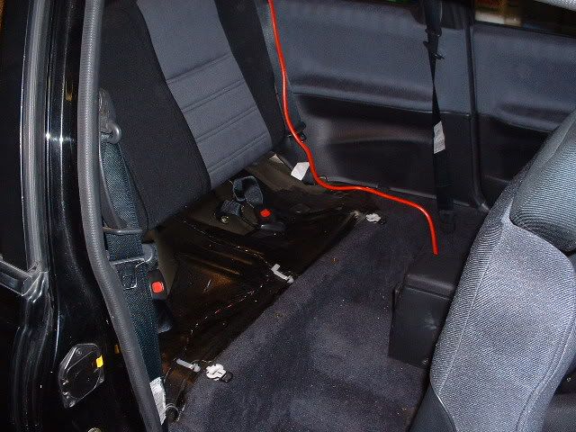

As it's been mentioned make sure you run the power cable down one sill and the speaker wires down the opposite sill. Run the RCA and remote amp wire down the centre tunel and make sure that all three sets of wire do not touch and have the miminal contact as possible.
Here is my power cable for the install - 4 guage!
I take it your going to run 4 channels for the 6x9's and componets and the other 2 bridged to run the amp? If so the amp is going to struggle to power the amp. You should really have a seperate smp for the sub as it will have dedicated power to run it all day long. Just my 2pence worth.
