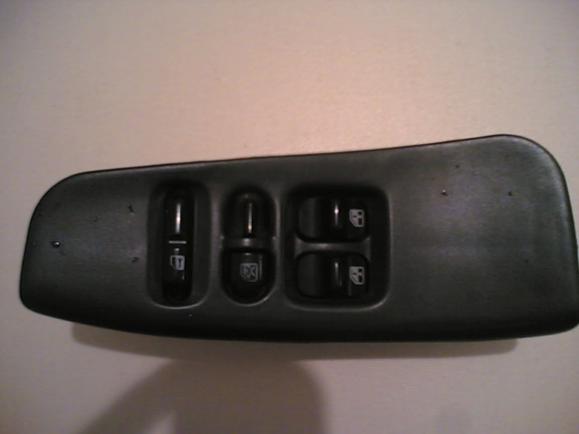

jpward
Just got my windows working again :D
This is the bliter that causes the head aches!!

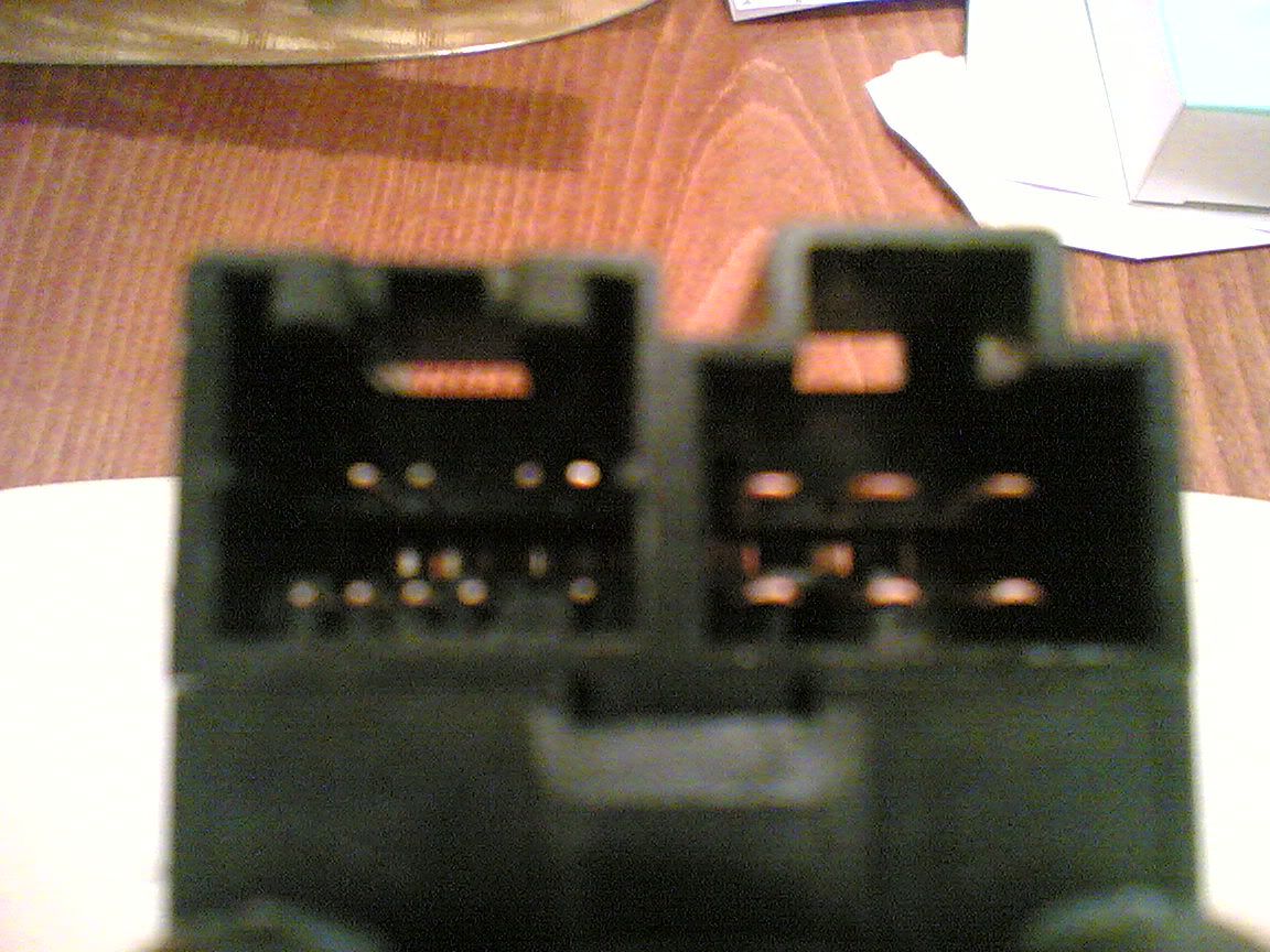

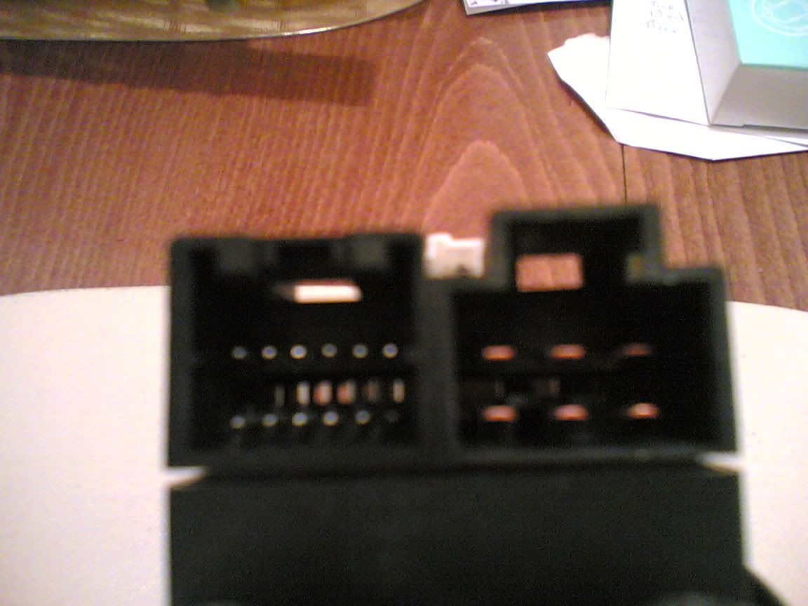

Also im postin pics of the 2 units old first and then new one look at the terminals do people have type 1 or2? (think my unit was changed in Japan before i got the car)
