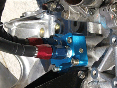

This pic shows the OE oil take off with aftermarket take off plate where the OE oil cooler is right?

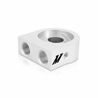

My goal (if even possible) would be to eliminate all that (OE take off and cooler) and replace with aftermarket take off, installed directly on the block, like this one
Obviously with a cap or plug, then run lines to a filter relocation bracket and thermo sandwich plate to run an oil cooler.
But how many sensors are on the OE take off? Oil temp and oil pressure? I'd have to make sure that the aftermarket take off on the block has a few ports for OE sensors...
You can buy a take off like this but there is a bypass valve built into in the standard oil filter housing. Think its been discussed on here before but i can't remember if i was a good or bad idea to remove it :?

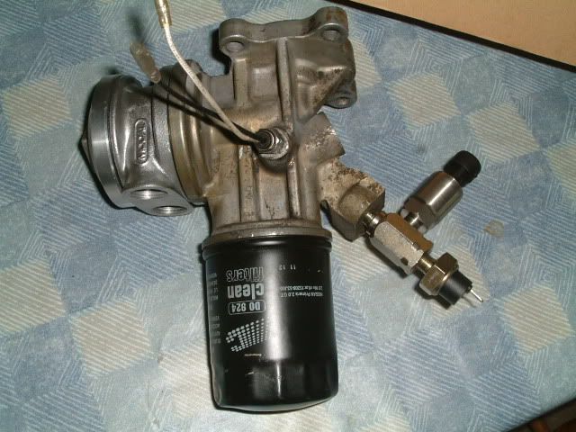

Slow reply but the example you show in your pic with the oe oil housing and after market oil take off is the same as my setup.
