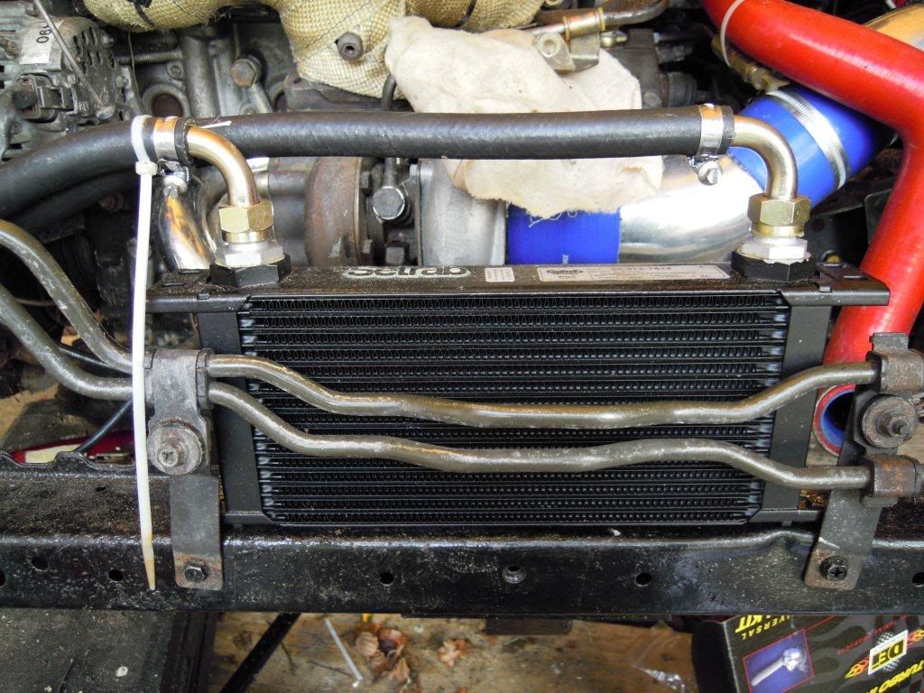

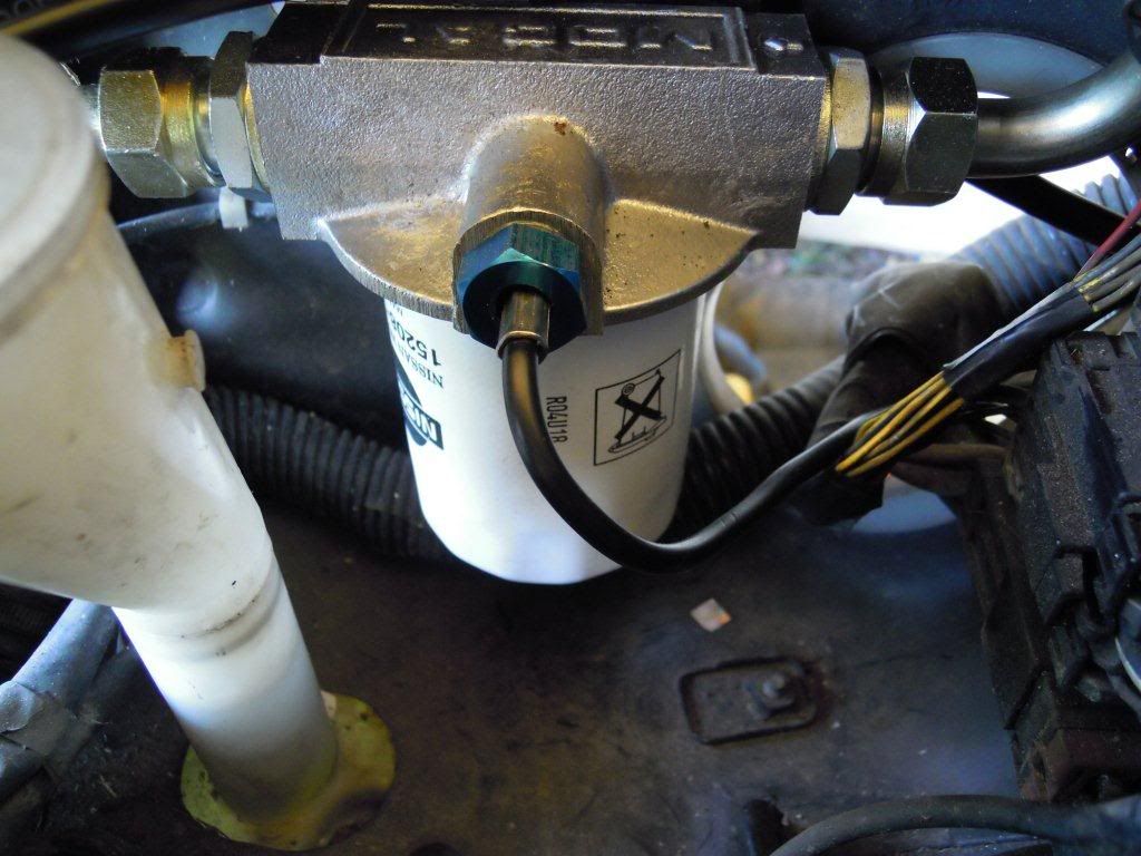

[FONT=&quot]I've relocated my filter to the os inner wing while fitting front mounted oil cooler and manual oil temp gauge.
It's easier to replace now but I could not fit thermostatic sandwich plate as it would not have passed oil through filter until it was up to temperature.
This configuration would not be ideal for a road car that is used for short journeys as it takes a while for the oil to reach normal operating temp.
