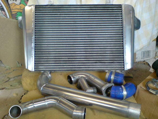

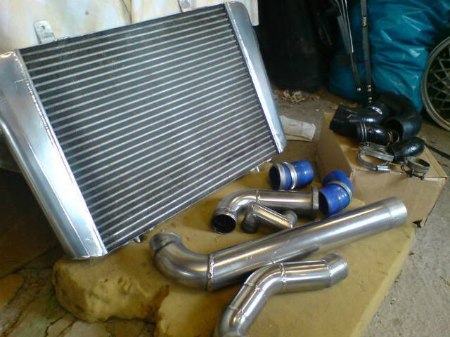

Just bought this:
Anyone got a photo with one of these fitted?
Mine seems to have a different pipe run to others I've seen, I know Pace made a mk1, mk2 version etc, but haven't a clue which mine is :doh:

Its the hose setup on the drivers side that I'm a little unsure of.
There is a small alloy joiner that alters the path of the top radiator hose, and I was hoping someone had a photo that showed what it looks like.

Here's some pics of mine, it's the Mk1. You can just about see the radiator top hose mod in one of the pics, basically you chop the existing hose in half and use the end bits to mate the alloy pipe to the head and rad. It takes a bit of fiddling around - on mine the rubber bit going onto the head is really kinked, but it's held up for 4 years or so.
Kit looks good, the pipework is better than mine - someone must have told them what bends were :)

Tim GTiR
Those photos are a great help, thanks alot :thumbsup:
Looks like i'll have fun fitting it.... Ah well, looks like its worth it though, looks a good fit :-D
