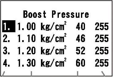

I just have one question. One the following setup menu:
i've set 1. to my target boost of 1.4, and reached 1.43 as shown on the controller's monitor. I'm unsure what to set the duty to (third column on the menu where it says 40 on the example above) Should i set it to the same as inj. duty under settings which is currently 65%?
I read on the PFC FAQ that if it makes the boost too easily, or overboosts to trim the duty down on the above menu.
I also read on the same site from PFC's instructions that if it's not the same duty setting as the one under inj. duty the car may hunt. Does that mean i lower them both?
Or, should i be happy where it is? Pretty spot on really. I just don't want to be chucking petrol in there for no reason!
Am i right in thinking it's asking for is a max duty value @1.4kg/mm2? In which case 65% is right for my injectors as that's what it's mapped to.
