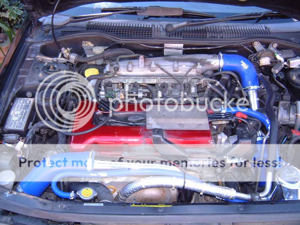

pics of forge front mount and pipe work?
Anonymous
any one got any pics of the forge front mount pipe wrk and hosing off the car and on the car fitted with out the front bumper? appreciate any pics cheers :)
Anonymous
also what diameter are the intake/outlet pipes on the cooler?
Anonymous
yeah im intrested in how both sides are routed any more pics??
Forge supply a new turbo outlet pipe, it come up and over towards the drivers headlight, behind the drivers side headlight, under the outside corner of the headlight and round into the intercooler. It goes out the otherside down round and under the front car through that gap between the big bar and the front cross member and then up towards the plenum chamber.
