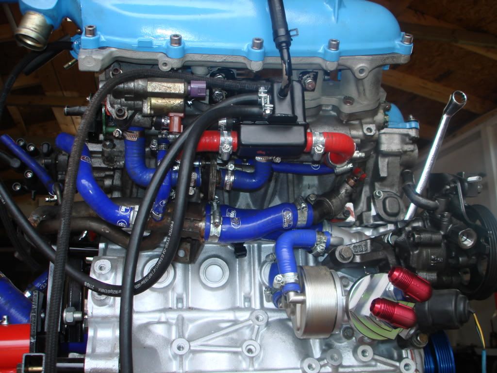

there are 2 of them nick on the back left of the head (above the power steering pump), one sends the signal to the clocks,one sends it to the ECU and controls the fans.
