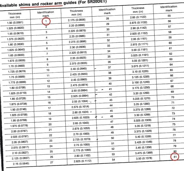

Looking at getting my first gti-r. Have found one that I like but it is quite 'tappy' from the head. A friend of mine thought it was the oil pump so he has changed it but still the same thing. Is it possible that just the shims will need replacing????
If so, what are they? Where can I get them? How much for?
