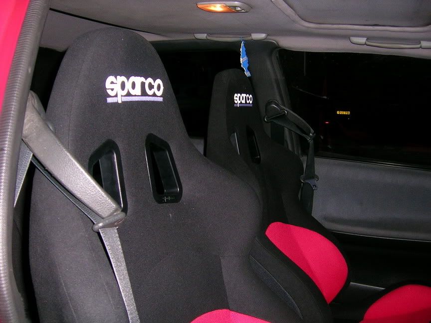

daz
or like this ????
and no i didnt use cobra subframes fitted the sparco seat to the original runners so that they mount and are the same height as the oem ones. but yo do have to take the original runners to bits and a bit of welding is required

daz
no instructions mate all done ad lib so to speak but i do know how to do it. as i said just made to fit from the bits i had
