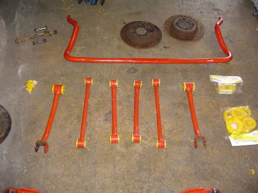

have fitted this know but used four small rings on the subframe (which is wrong according to the top instructions) wiil change them later. fiited all today
teins set to equal height all round and on softest setting..
trailing arm bushes
control arm bushes
whiteline adj rear anti roll
subfame lock kit
anti lift kit
front control arm bushes
link bushes
new nismo ball joints
front anti roll bar bushes
early thought's after drving for a bit ,is that it rocks!! :lol: :lol: 8)
car is completely different steering more stable/solid, understeer (what understeer!!) :p going around a rounabout the rear breaks traction and can get into oversteer slide. :twisted:
have yet to fit the bumpsteer
set the suspension geometery
lower the ride height a little more
change the subframe bushes to big one at front and small rear
pic's below of some bits
