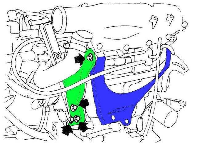

Sorry to bulge in. Is this the Y bracket under the inlet manifold you are talking about ?

There is another bracket on the passenger side just below the inlet hole, can that be removed too ?

i think its best just to remove the y bracket,best to leave the other on to give the inlet some support,i could be wrong,any1 back me up?also when puttin the gearbox and tranny box back on the block do you have to use some sealant?
Nope, cos i binned that one too ;-) :lol:

,where did you put the earth wire that comes off the bracket?its not the y bracket its the other one you have binned theres a wire on the side of it,can you earth it anywhere?coz ill leave that off 2
put a longer bit of wire on it, and take it to any good earth point, think i used one of the points where recirc valve was bolted
