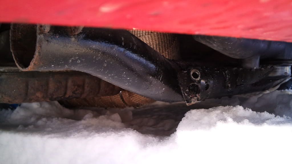

I cut off the lower rad mounting points, spun them 180 degrees and welded them to the round cross member. Then cut off the piece of metal that joins the round cross member to the square cross member (if that makes any sense). This will give you enough clearance to drop the rad but you will have to notch out the round cross member for the lower rad outlet. Then you'll need to lenghten the lower rad hose, i cut it half way up and joined it using a 100mm joiner from ebay (iirc its 35mm dia). I think i have some pics somewhere, if i find them i will post them tomorrow.

nice one for the pic mate i think i am going to get a ally rad to save the hassle of cuttin and weldin wilkl post up some pics once its done thanks guys
