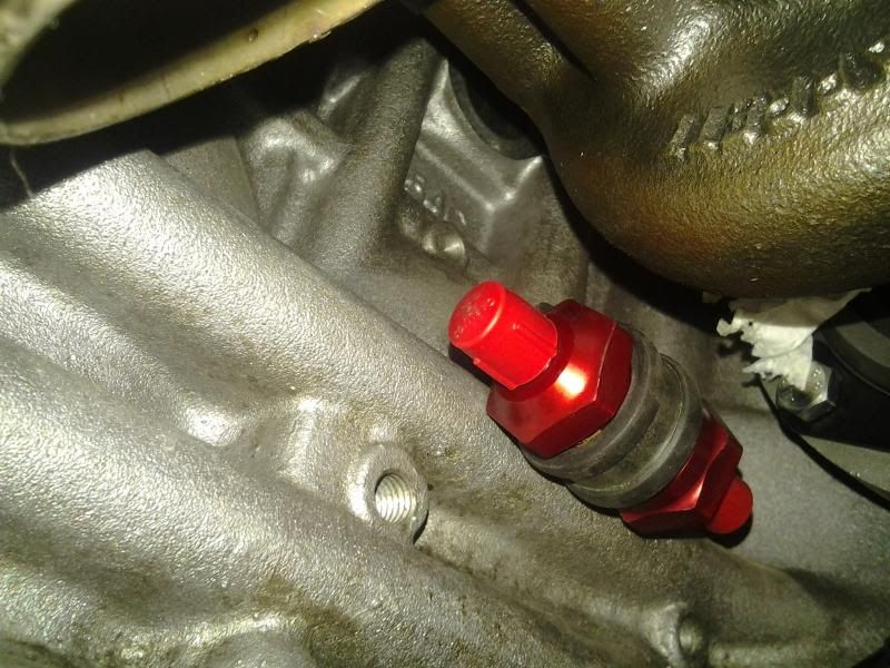

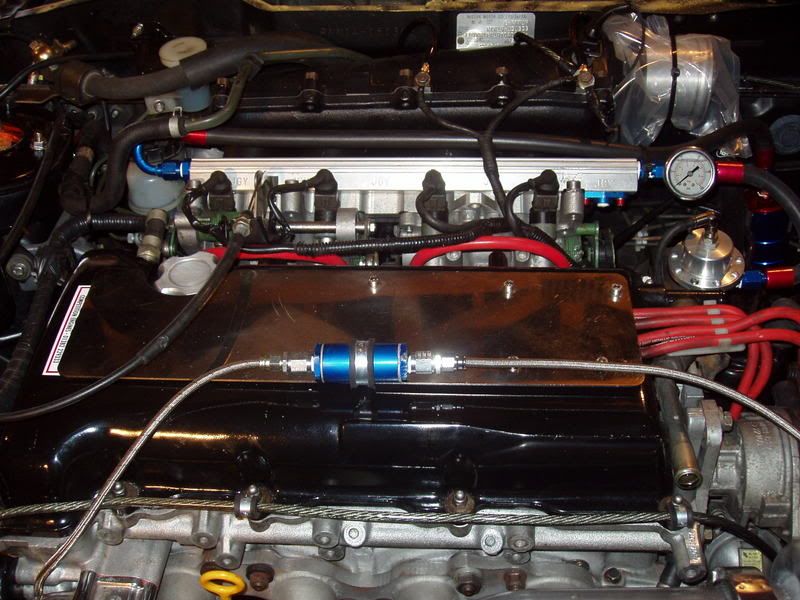

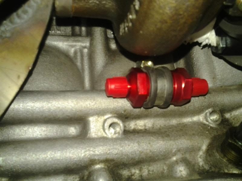

How have you guys mounted your inline filters?
Not to keen on just letting it hang free in the line, and finding a place to mount it is proving a head ache.
The best place I have found is off the stud that the original pipes used to bolt to, but its pretty close to the turbo.
I am hoping it will be ok but just wanted to see what you guys think?
Tbh where ever I try to mount its always close to the turbo or elbow unless I start running stupid length lines.
Its only just hanging there atm, and I would obviously have to remove the rubber lining from the p clip and possibly may put abit of exhaust wrap around it before I mounted it.
But from there I think I can get a nice run up to the block with a 45degree and a banjo and off the right a 90degree then up and over onto the turbo with another banjo.
