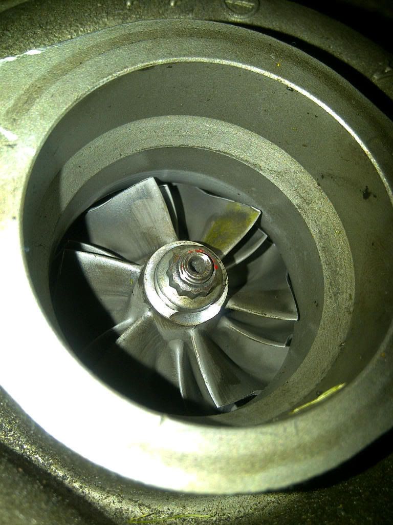

Anybody know any decnt place that can recon my turbo for me? Got a quote of turborebuild.com and they said between 250-350 depending what needs replaceing as on my old turbo it needs a new shaft as the properor (inlet side) has been in contact with the houseing.... Does that seem resonable? Includes all the seals and bearings and balancing.....

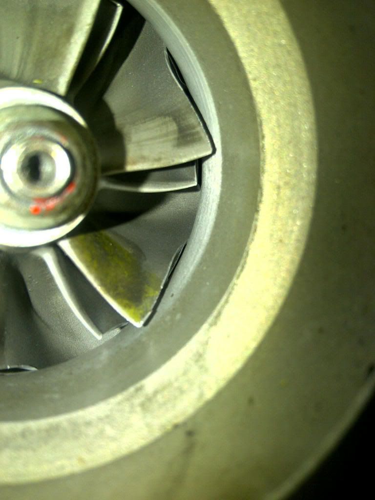

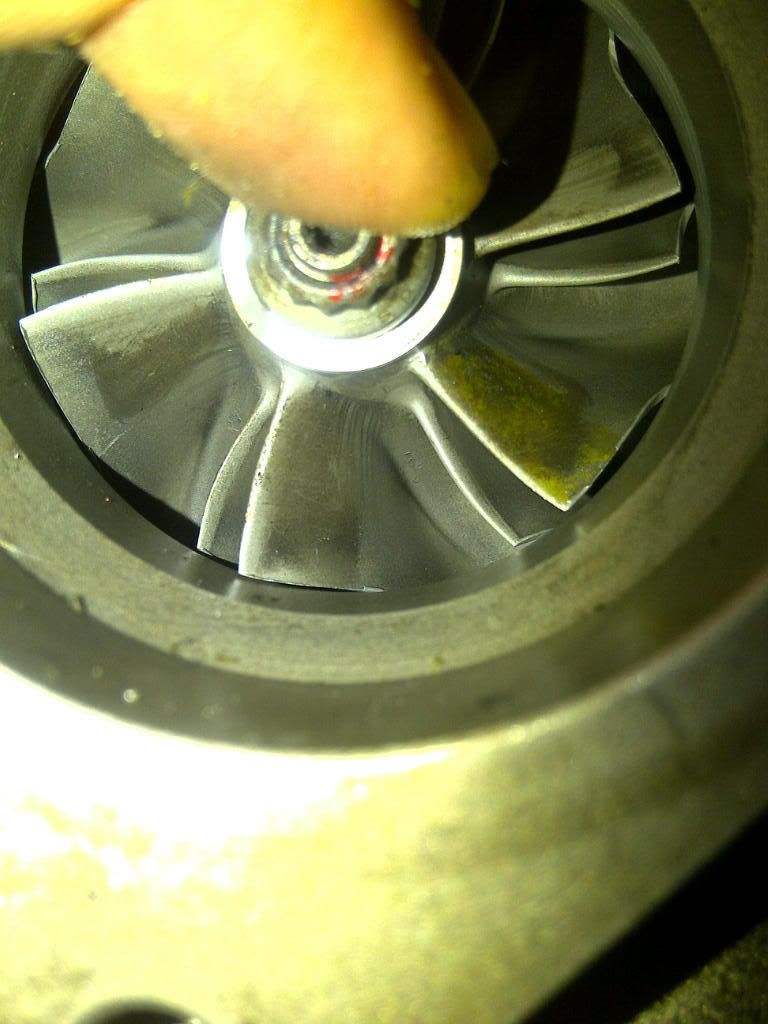

Yes mate theres some small marks where its been touching the proplor (inlet side) and you can see on the old turbo where little 'file' size metal flakes are coming off the propellor
wrc

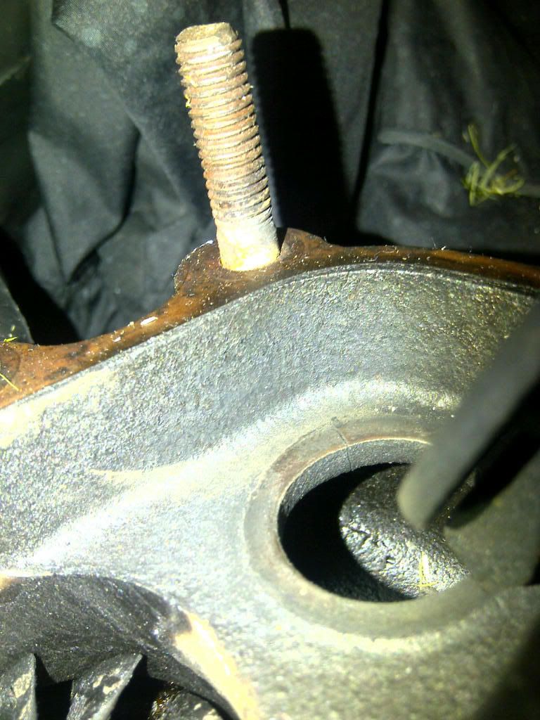

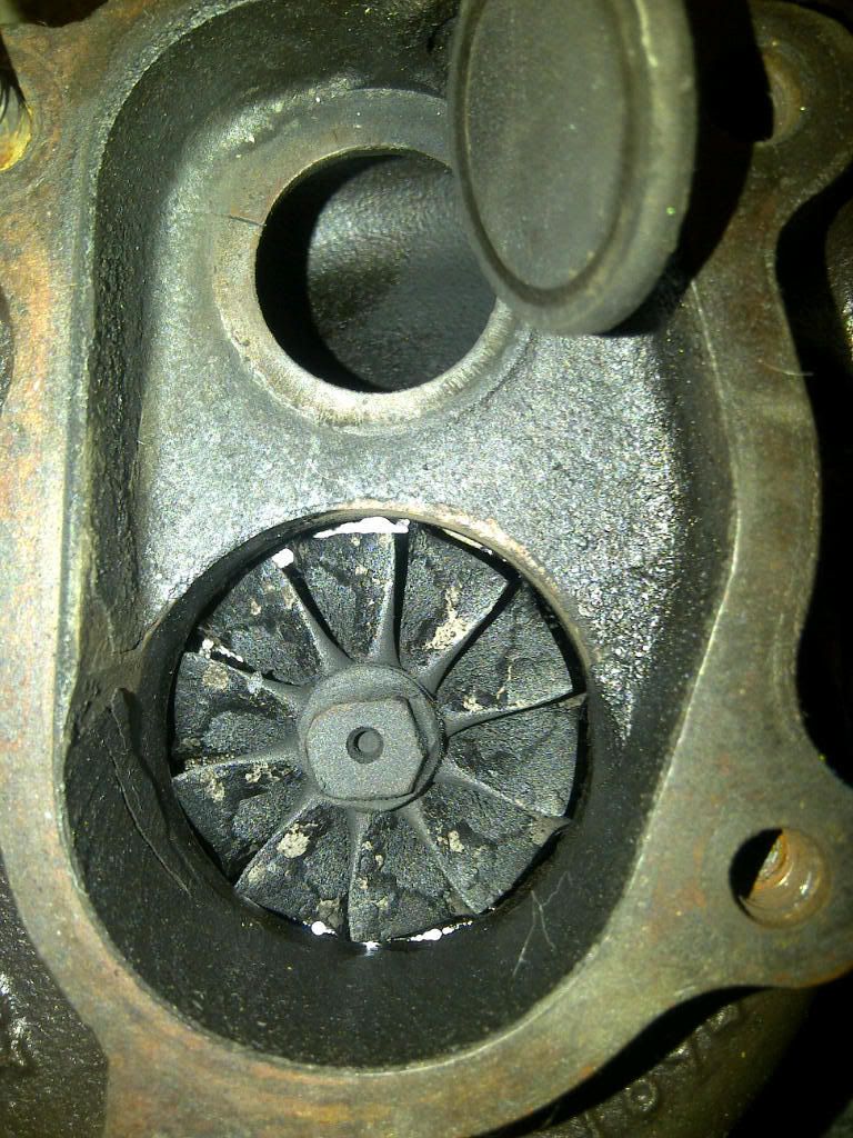

Not even worth a re-con mate. Compressor damage is quite severe so has probably done the housing in, and the waste gate is cracked = new housing again and that turbine wheel looks rough. New turbo.
chrisyleigh
BASTERD didnt see that crack untill i properly looked at the pic can darkish garage so camera light .... Dam , most of thats burn oil .
