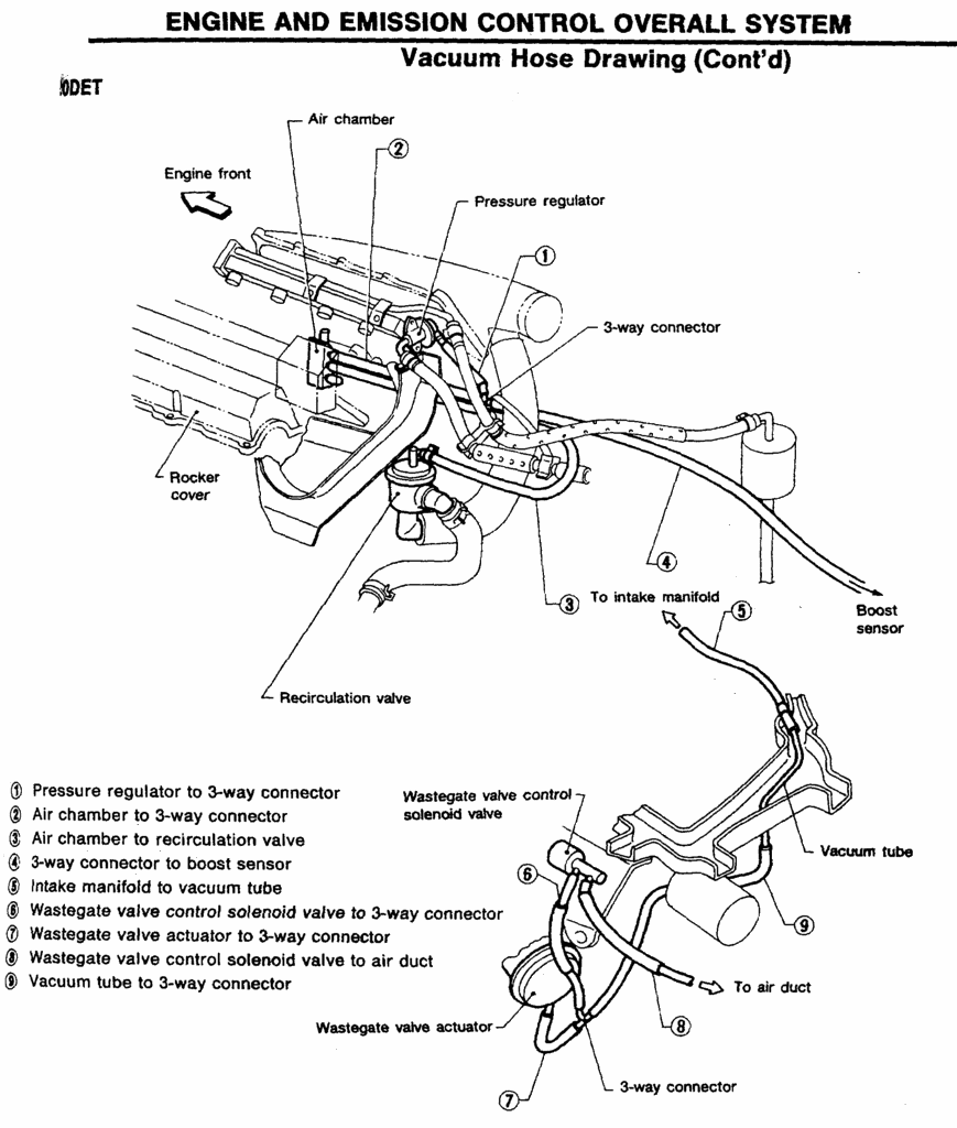

Hi can you please check my vacuum pipe layout as the engines been out so long I have forgot :doh:. I think its all ok as I have looked at the manual but the carbon cannister was missing when I bought my R. I just want to be sure before I bolt it back in the bay.
Pics can by clicking the link below
http://www.naughty-dogz.co.uk/tinc?key=Wi7JFPWb&fs_settings=1,2,1,5,800,740
You may need to roll your mouse over the text at the top for the full description of where the pipes are going.
