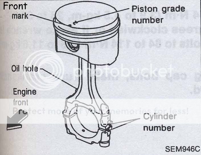

so cylinders numbers on the rods facing the front of the car.Fast Guy said:According to the manual, the cylinder numbers on the rod should be facing you, with the pulley (front) end of the engine to the left. Front mark on piston facing the front end of the engine too. Hope that makes sense.
perfect!!Fast Guy said:
Yeah, pulley/timing chain end.Jobi Joba said:engine front is the timing chain side on manuals,right?
