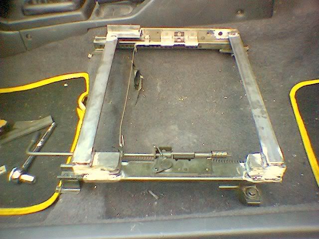

I thought I'd post a pic of my nearly finished subframes. They still need some sanding and painting but being bare its easier to see what's added:
You can see the near side needs to be raised about an inch to be the same height as the far side.
Both sides needed extending at the front to put the cross bar in the right position of my holes.
I'm sure there are simpler (lighter :shock: ) designs but using the sliders, you can see the far side has only increased 1cm tops and the bottom of the slider is nearly flush to the bulkhead.
Nad, if you used a fixed frame you wouldn't get these problems but I decided for me, a fixed frame would not be practical.
Jim

Nad said:
I take it this issue is only with recliners on sliding rails and not with buckets on fixed mounts??
Nad
no, I've got fixed back buckets with the manufacturers subframes designed for the R and still too high, even after removing the spacers and welding lower braces.... :evil:

What's the clearance between the floor and the seat base at the front? I'm interested to know if Bride/Nismo have been able to create a lower base or not. IIRC, the mofidifed runners put the seat about 15cm above the floor.

i will take a pic of my BRIDE Seat in the car , with the BRIDE Rail, it sits much lower than the stock rail

This make very interesting reading.
Being 6-2 and with a helmet on when racing it I find the standard seat to high. I am trying to get a standard seat so I can cut it down and weld solid then fix into the in the best possition for me.
I dont want to ruin my standard seat so I can put it back in if I sell the car.
learnt a lot form these posts.
Once i can get a seat ill let you all know how I got on. I need to be at least 25mm lower.
Phil
Happy to help. I reckon with some cutting and welding of the outside subframe and moving the inside mounting oint down you could lose and inch at the back of the seat. Like mine though it woun't be a simple job.
Good luck.
Jim
