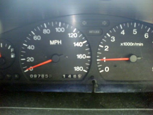

I started her, waited for the idle to settle.
Disconnected the TPS and fiddled with the idle screw; it's as low as it'll go.
Reconnected the TPS and the idle jumped up, then settled back down again.
Squished the vacuum line to the BOV.... 1500....1250.....1000.
Released it; and it stayed put... blipped the throttle and up it went again... clamped it; and down it came to 1000 again.
That makes sense with the idle going up after I've been driving because the valve will have opened (and not quite shut again)...
So; do Bailey sell a rebuild kit with new O-rings, or am I up for a new BOV? (Maybe one that fits without a dodgy double plumbing job.)
EDIT - A bit of research suggests that what I have installed is a Bailey DV24; single piston blow-off valve for carburetted engines. I need a DV26; dual piston unit for engines with an AFM (to enable a steady idle).

Well, here's an update for you all...
I've been away this last few days, and that involved driving from North Wales to Norfolk. Here's the odd thing; after about an hour of driving the idle dropped to ~1000... and has stuck there ever since.
I pull up, it reads ~1250... give it 30 seconds or so and the idle drops to where it should be.
I don't know what I did, but it seems to be working - it's actually a little disconcerting because I keep thinking that it's about to stall.
