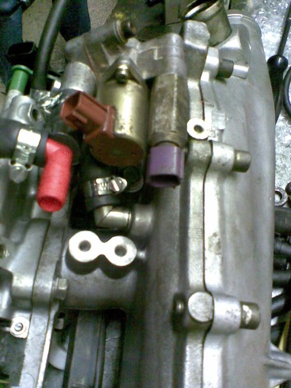

radiobar said:
why dont you use this here as vacuum for boost meter,fuel pressure etc. ?
http://www.weidewaren.de/Inletmani.jpg (see my white mark)
on my car is blocked by a black cap
do you connect the brown and purple plug or not ?
and what about the idle control ?
will it still work ?
I use the point you show for boost control etc.
I do connect the brown and purple though once I forgot and didn't notice really.
I got rid of the auto choke and when cold my car idles at 600rpm for a few minutes. It sill works though and I just mapped my PFC accordingly.

radiobar
hi !
looks nice.
what have you done to the outlet of the idle control ?
just blocked ?
and where is the pipe going that is next to the brown connectror ? (right side)
Trip
radiobar said:
hi !
looks nice.
just blocked ?
my engineer blocked it.
the pipe routing is not finished yet. i run out of clips :doh:
radiobar
hi !
ok, i see.
but why dont you block it ?
would it be possible to block all outlets ?
you could use the small one on the left for boost,fpr,BOV,etc.
and one of the bigger outlets for servo.
thanks
Trip
radiobar said:
hi !
ok, i see.
thanks
I didn't really understood you
You cannot block the two 12mm "L" shapped inlets. They are used to allow air in the engine when the throttle bodies are shut closed. They basically bypass the throttlebodies. The Orange connector soleniod regulated how much air passes to adjust idle.
radiobar
hi !
ok,i see.
i think you mean the 2 inlets behind the throttles.
on your pic there is only one and the other is on the right side.
will the idle screw still work ? i think yes.
but you could block the outlet next to the brown connector(right side) ?
i need to know everything for sure before i do it.
thanks for help
Trip
Yes
It should :p
Can you show me with an arrow or something please. I can only see the red T connector next to the brown connector, which will be connected with another T to the right side and finally to the brake servo.
radiobar
hi !
its next right to the brown connector.
i just checked my manifold and it goes to the valve with the idle screw.
so it can be left like it is.
now i think i know everything.
thanks for help.
thanks
