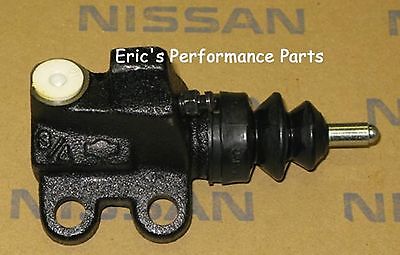

Should look like this ?
Yours don’t look right to me , creaking sounds like it is having a massive load on it , it is pointing to something wrong at the slave / clutch actuation fork or the clutch itself - somehow wrongly installed , wrong plate or bearing - it should not be that hard to operate
andy_tt
The slave looks like that. The rod just didn't look right. I think it's just to much load for the master. It' was fine till I adjusted the rod is out of alignment as it's adjusted to the end of the rod to make it work. The fork moves . The little slack there is, you can see it's not seized
