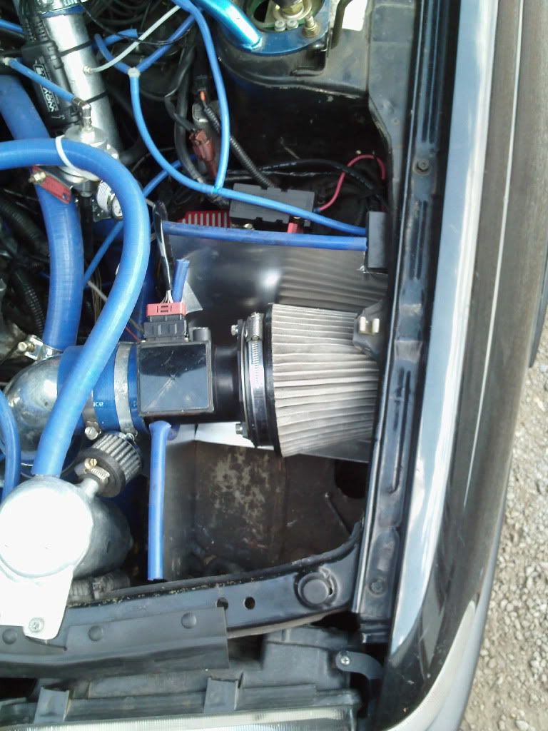

How big an air filter do I need for this turbo(will run around 1.7-2 bar)?This is the one I have on and its not that big tbh but maybe its fine as is?Its connected to a Z32 MAF to give you some scale.

I mean does the one I have look big enough?To me I don't see how a bigger one will particularly flow more air as it all has to go through the opening of the MAF anyway and the current one covers much more surface area than the hole in the Z32 if you knwo what I mean.
My old one on the standard MAF was twice the size but does that make a difference ie was it overkill?
The more free flowing a filter is the easier it is for a turbo to spool up, It's not all about how much it can flow for it's size, I think my filter is rated at 650hp.............but will the car ever make it?
Try to think of minimising any restriction on the inlet,because if you do you will loose a huge amount of power and also you will make the power move further up the rpm scale.

Sorted out the air filter area this morning and made a new heatshield for it, lot less restriction to the filter now.

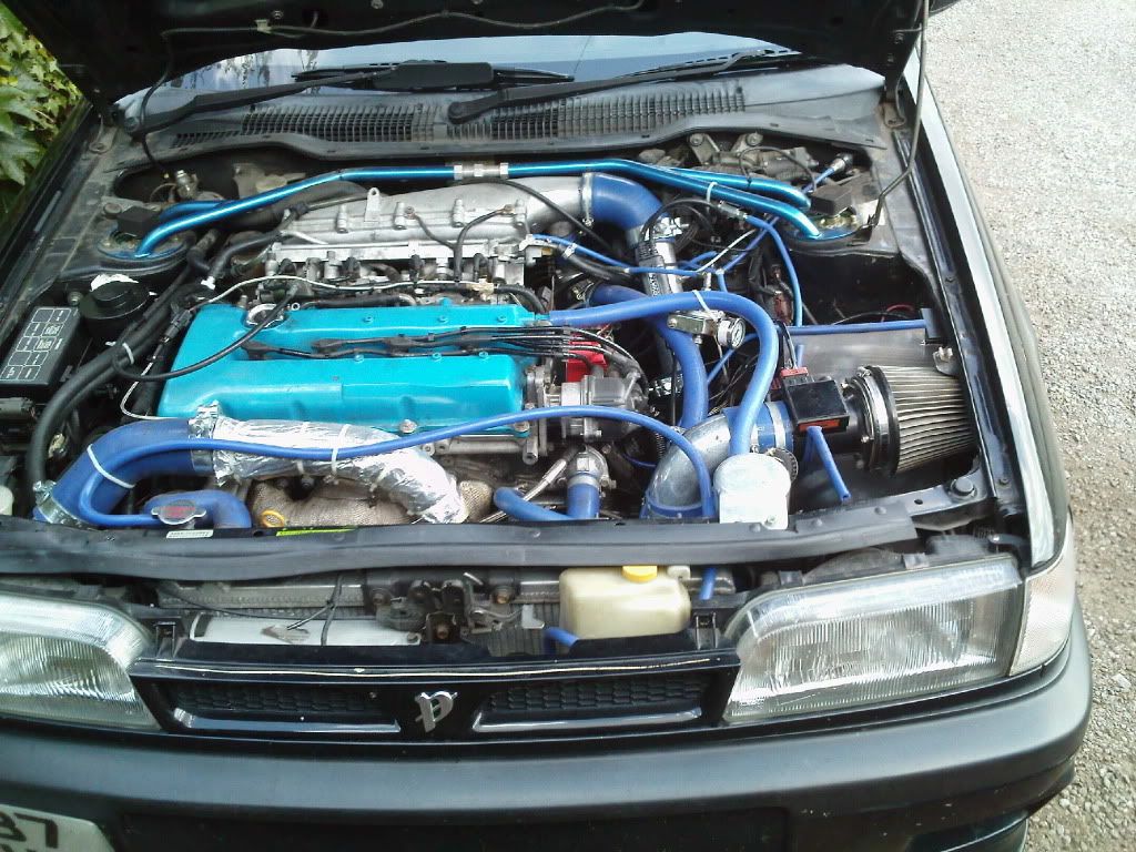

Noticed you have your innovate wideband controller fairly close to your distributor tie wrappped to the intercooler piping. If I wa you id move that round to the opposite side of the engine bay as far away from the dizzy as possible. they've a reputation for the eletrical interference or something like that from the distributor frying the electronics in the unit as I found out to my cost when i decided to mount mine right next to it.

The innovate is whe Ed at Fusion fitted it, due to space constraints.I guess I can canle tie it to the strut brace which would nearly double its distance from the dizzy.
