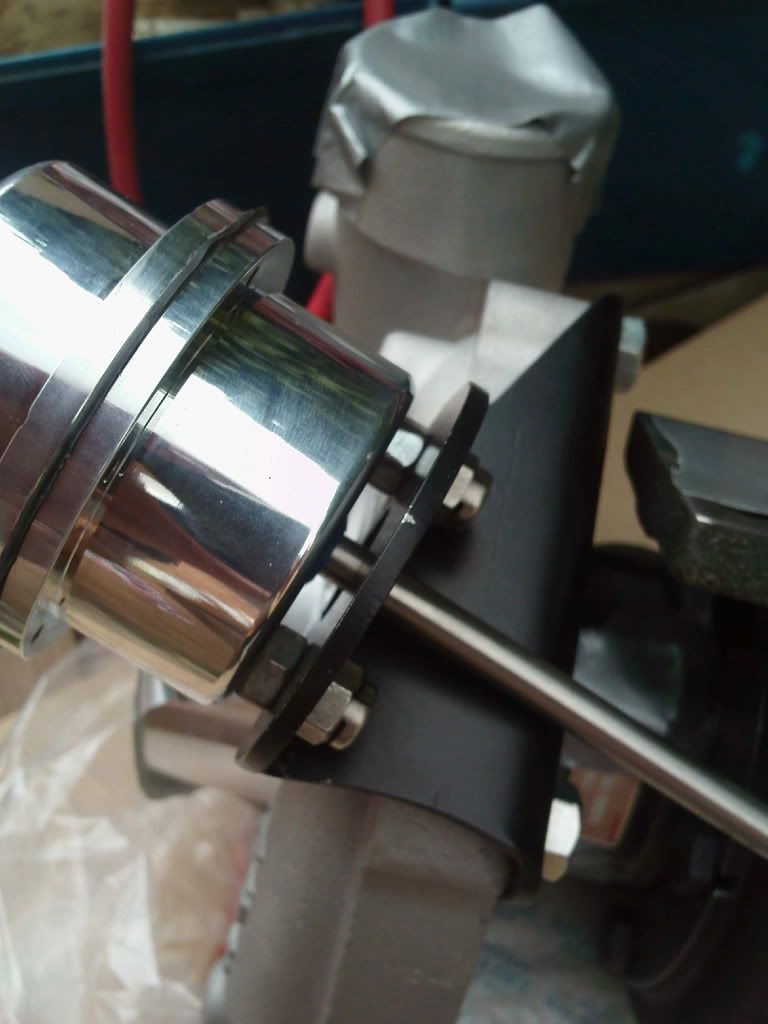

I forgot to mention I already have a Forge 1.2 bar actuator so shouldn't have any worries there.The rod is a bit long but I'll just introduce it to mr.angle grinder.

BTW I had to chop the Forge actuator rod down about 1/4" and space it away from the turbo dynamics supplied wastegate bracket using a couple of nuts as that was the only way I could get the wastegate to be tightly shut as when the wastegate was flush up to the bracket there was a bit of play in the penny.
