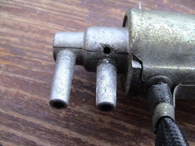

Do you need an uprated fuel pump as well for this mod? And does anyone know the exact diameter of the hole that you need to drill?
alfyboy
Yes its advisable, think the hole is 1mm

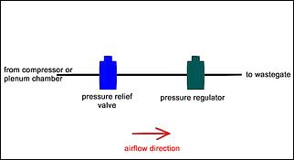

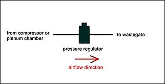

Why do you need to loop the solenoid??
Can't logically see why you would need to, it doesn't sense pressure it just opens and closes on command of the ECU. And I think it is only closed when the DET sensor is triggered or the ECU goes into safe mode. In normal operation I think it just bleeds a certain amount off to the inlet.
As usual I probably have it wrong.
Let me make sure I have this right.....
You pull the 2 pipes off the solenoid and join them together. Then you get a piece of pipe and use this to connect the 2 stubs on the solenoid. ?
So what this achieves is that some boost pressure that would otherwise be hitting the actuator is effectively bled off back into the inlet tract. ?

I've just done this....we drilled a hole of 1.5mm and it boost to 0.8 bar,
So we completely by-passed the solenoid to see what happened and it sat dead on 1bar boost....is there any reasons why i couldn't keep it by-passed? do you think it would be alright?
