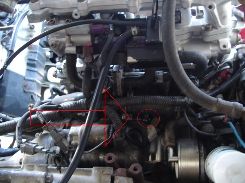

Well there seems to have been a little progress made, as a few maybe know i took the R on the track at Silverstone a couple of months ago and the car ran well as expected, however i had the above mentioned niggly little problem still. Since the track session the niggly problem started to get a little worse which funnily enough i was glad about lol as it really is a pain in the ****.
Initially when i had this problem as already mentioned i carried out an ecu check and the results came back 55, all ok. Anyway now its a little worse i thought ill try again and lone behold it produces a code of 34 DET Sensor which runs in line with the symptoms im getting, so now i am on the look out for a new ideally DET Sensor.
So although this costs a small fortune, im pretty happy that it is what it is *famous last words lol* so now at least i can be pro active and get this little pain in the **** sorted.
So any help will be appreciated, tips, photo's suppliers etc etc, please all information welcome, cheers guys and gals :thumbsup:

Quote from this thread below:
it was a nightmare. I jack up car, dropped down pipe of. had extension after extension on a ratchet with a knuckle on the end. I manged just to crack it slightly, then undone it by hand. It took a while, but got there in the end. I'm going to relocate mine, thats too much work for me.lol
Think ive read some people take wheel off and go in that way. I tried that but not much luck."
Some info here: http://www.gtiroc.com/forums/showthread.php?t=44305&highlight=knock+det+sensor

I put it back in the OE possition.
Too important an item to get wrong!
Thats what my first thoughts were to be honest, i wouldn't want to get that wrong, its either too much or none at all really with this thing.
There's a guy selling the kits and says its a 5 min job with the relocation kit:lol: but also states to relocate onto the plenum:?
Anyone else any ideas?
