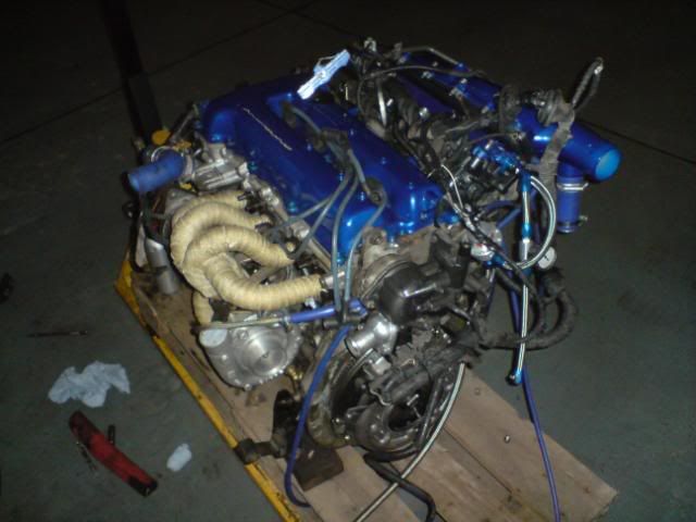

my new engine
i thought i would post a few pics of my new engine (esp for you pulsarmark)
hope you like
spec is as follows
hks 87mm pistons
hks 1.2mm headgasket
acl thrust, main and big end bearings
new small end bearings to fit pistons
full bottom engine balance
arp headstuds
arp main studs
arp rod bolts
arp exhaust manifold studs/bolts
new oil pump
new water pump
thermal inlet gasket
7-layer exhaust manifold gasket
dp motorsport tubular manifold
3071r turbo
a/m performance elbow
turbo and elbow heat wrapped

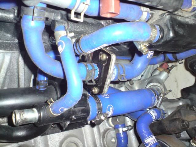

full samco hose kit for oil cooler/heater
full rear of manifold samco kit
new timing chain tensioner
new timing chain
sard rj fpr and gauge
braided fuel hoses
hks earthing kit

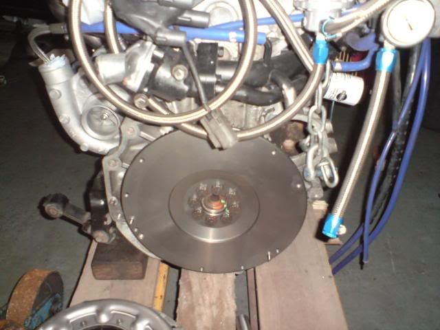

jun lightweight flywheel
helix heavy duty organic clutch kit
braided clutch hose
samco coolant hoses
forge oil seperator
nismo thermostat
z32 maf and 3 inch inlet pipe
16row front mount oil cooler(to fit still)
all built up ready to go in
jun flywheel
back of inlet

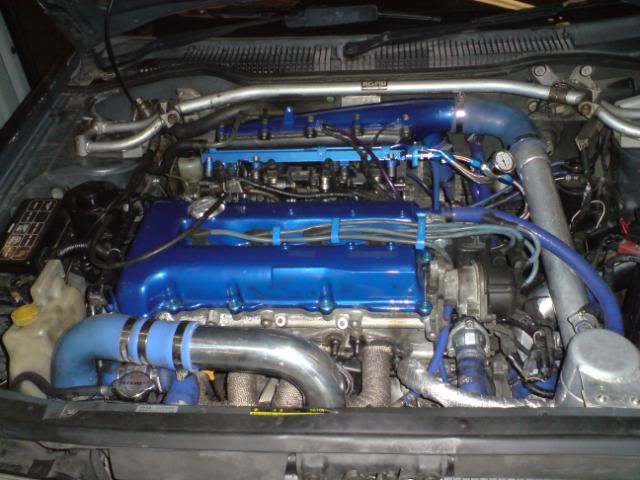

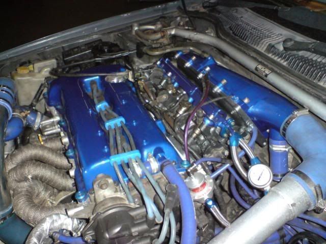

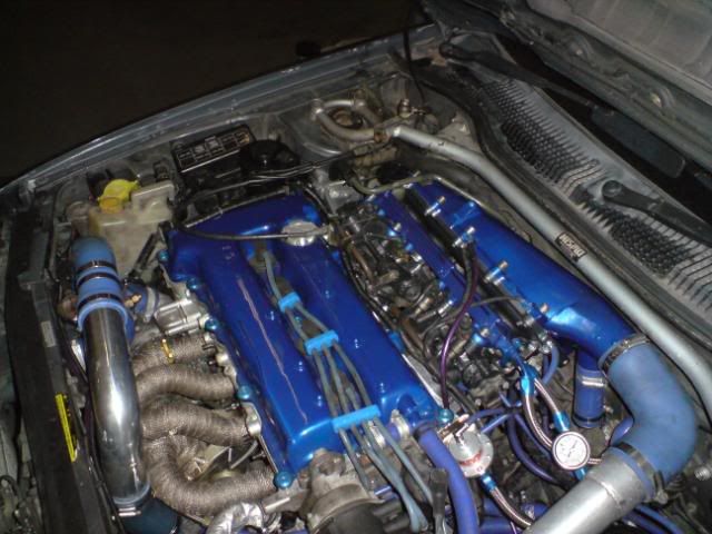

all in place
they are only camera phone pics so sorry about the quality
the front intercooler pipe is now sitting much lower so the hose does not touch the manifold, i just need to get it made up in ally now
i managed to get the old engine out and the new one in all in 1 saturday at work but it took 2 hours to get the gearbox back on lol;-)

looks good all the samco blues,
thats an area i should really cover, before upping the boost,:doh: ive got a few rad hoses etc,but could do with a setup like yours.tbh
davey;-)
GTIR-LOZ
it really wasnt hard to be honest the two newer samco kits cover most of it and then i just measured the old hoses and rang thinkauto up and they sorted me out the rest with discount as well lol
